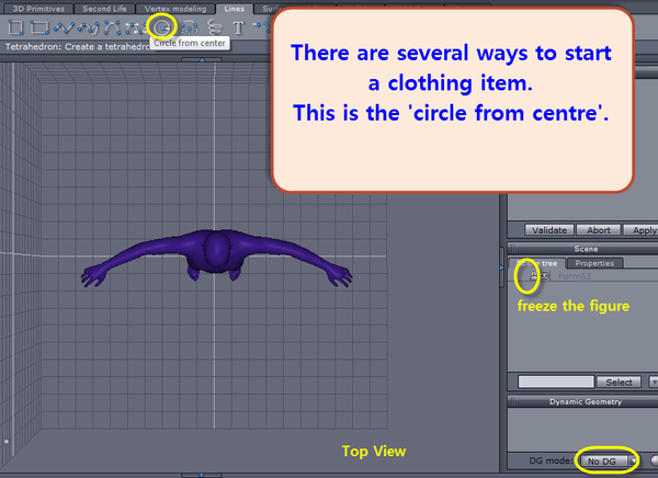

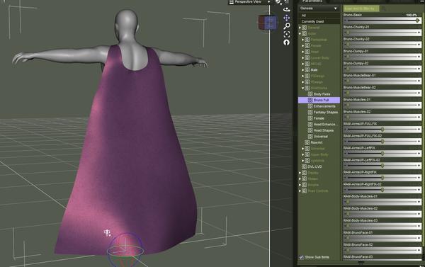

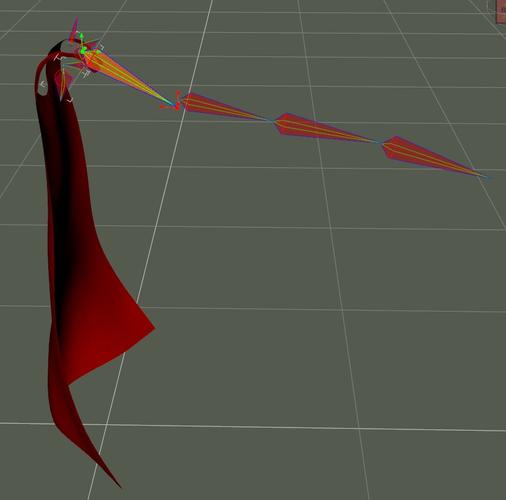

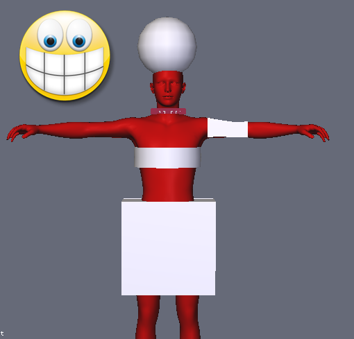

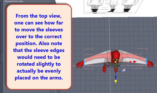

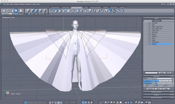

    The only problem with starting with a cylinder is the fact that it has to be modeled over a T-posed figure, and has to cover the arms spread out. Not only that, but the real thing is made from a circle of cloth, not a tube, and I really want to make this look and work as authentically as possible.
    Circle from centre, fill with a coon's surface, will give a flat circle plane ... sure would be nice if we could make dynamic clothing!

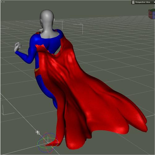

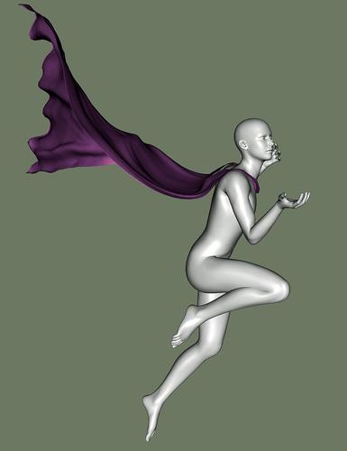

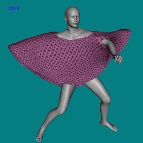

    Obviously a lot more surfaces would be required to model the cape, but this is what I was thinking of.
    Yeah. That's definitely not what I was thinking of. This is more my planned start shape. being able to make working dynamic clothing in Daz would be nice, though I haven't even managed to get Optitrex's dymanic clothes to work for me in Daz.
    1373 x 814 - 241K

    ...edit ...
    Yes, I can see that making a better wrap around cloak.

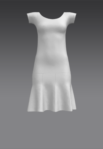

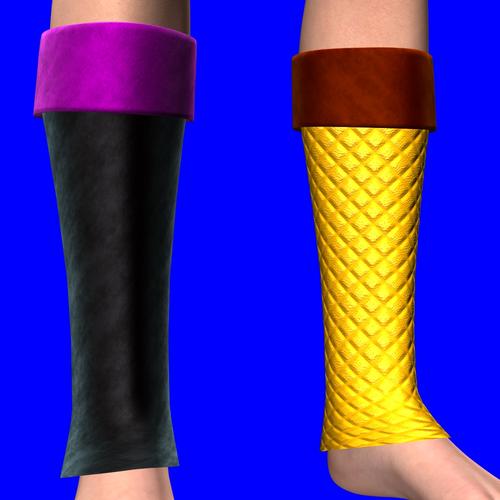

    Was working on a skirt ... btw - do NOT make piping bands for waistbands either. Not on Genesis. Was trying out a few different waistband ideas for "simple/fast" [as in I have not mastered those weights yet either] so ...
    But textures, got some nice ones in the works.
    Sneak peek:
    600 x 600 - 100K
    600 x 600 - 93K

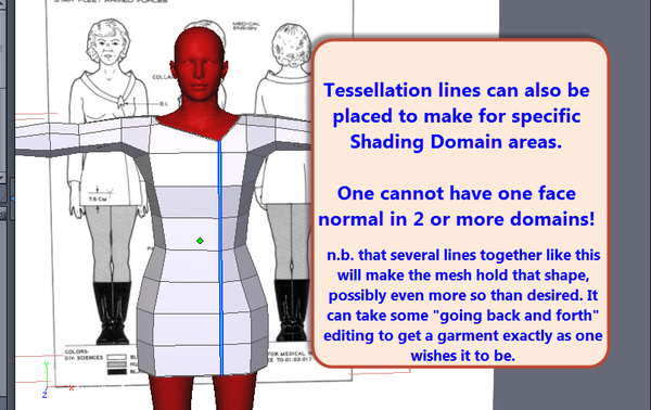

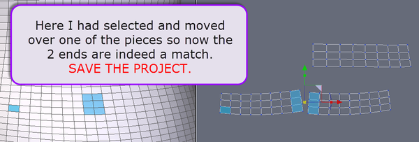

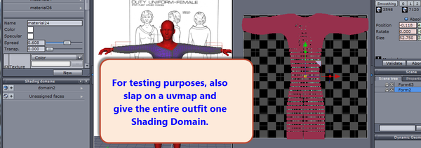

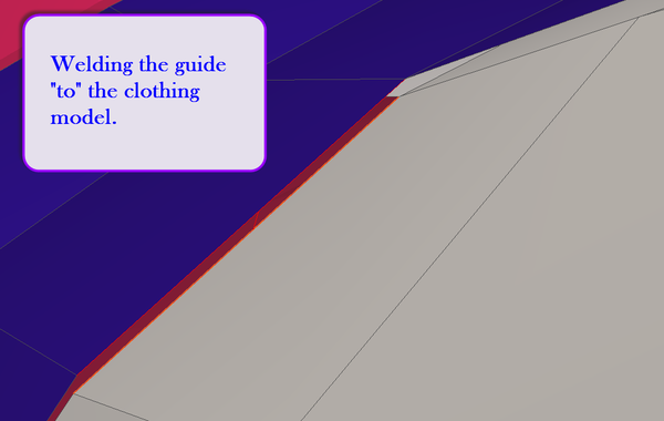

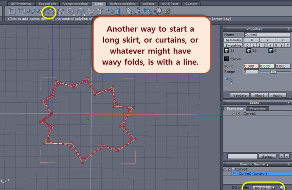

    edited February 2013

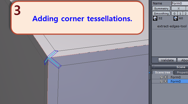

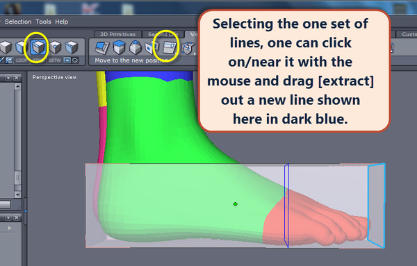

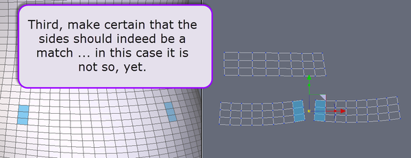

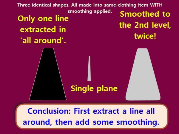

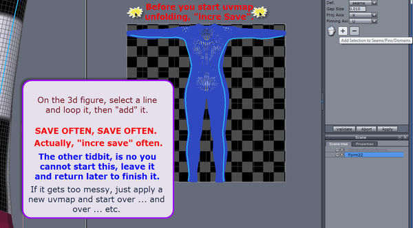

    This isn't going to be a complete tut. Just a start for another method of making a skirt.
    Lines can be your modeling friends ;-)
    ... images didn't load quite in order, however they are named in order.
    824 x 363 - 72K
    998 x 589 - 97K
    992 x 538 - 88K
    980 x 637 - 75K

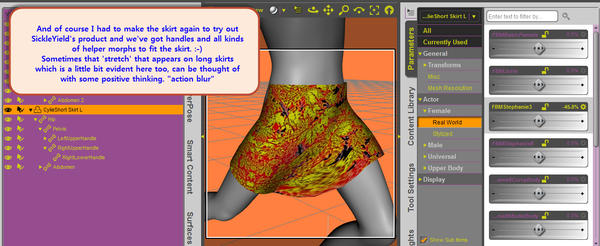

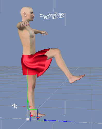

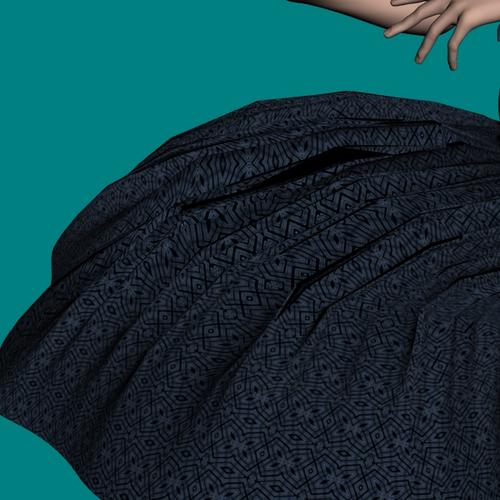

    I finally did it! yessirresir! [right click, add to dictionary]

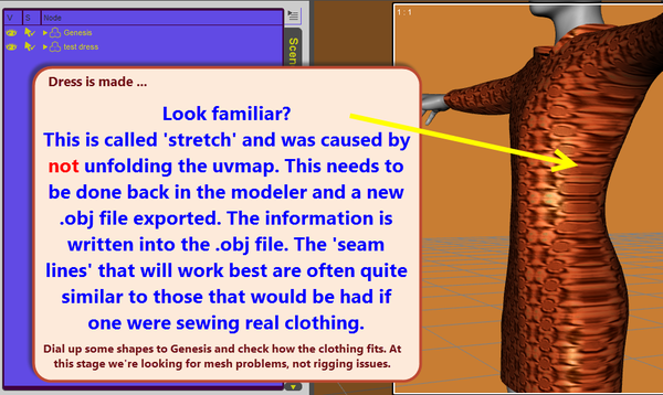

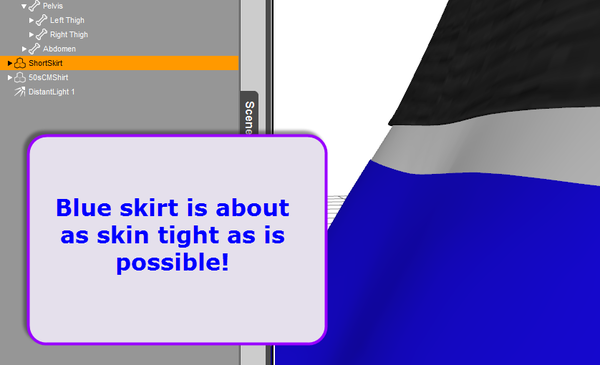

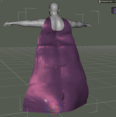

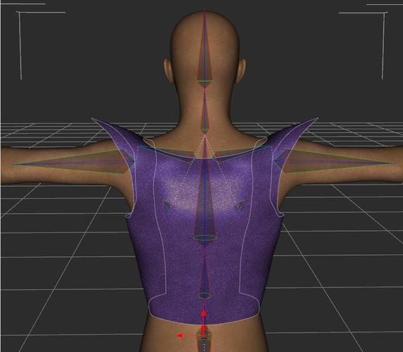

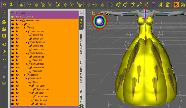

    Made a long full skirt that is smooth and wrinkles when it should :-) :-) :-)
    Made some skirt handles, applied some weight to the bones [now they work!]
    Skirt can 'sit' and it makes a lot of neat folds.
    A few of the wrinkles ... either doubled or I need to tweak some setting.
    600 x 600 - 239K
    600 x 600 - 82K
    600 x 600 - 86K
    600 x 600 - 93K

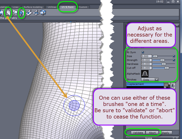

    Smoothing between groups in the weight group editor helps that somewhat, but it depends on your poly count - if it's under 10k I'd say subdivide it.
  • RAMWolffRAMWolff Posts: 10,382
    Looks really good though. Yea, Sub D it and it should smooth it out some more. I love the sitting morph or how you got the pose bones working there. Very nice. Some sitting morphs leave the dresses too .... I don't know, they look weird to me. lol
    Thanks for the replies.

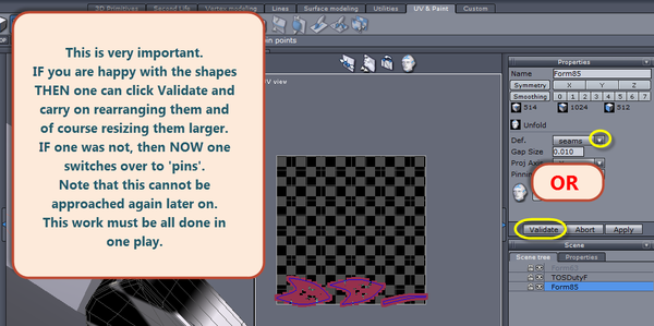

    I'll have to check the number, had smoothed the skirt to level 2 in Hexagon. As I'm still learning about the weight brush I suspect there should be a border of influence that is perhaps not set quite right. Next weekend I hope to have more time to work with it.
    The sitting skirt was done by posing the lower skirt handles.
    Oh if you saw the uvmap ... that needs a wee bit of work. I really wish pinning worked in Hexagon.

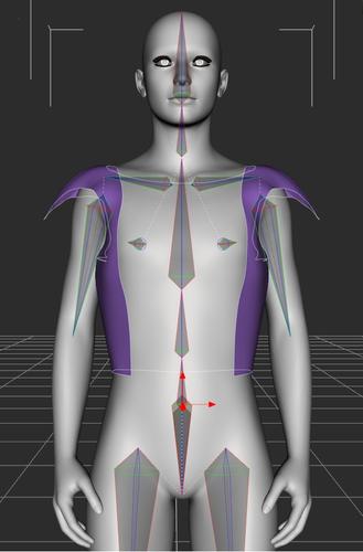

  • Tramp GraphicsTramp Graphics Posts: 2,433

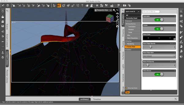

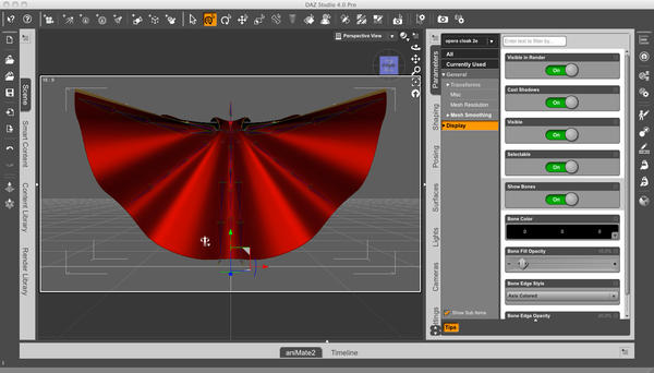

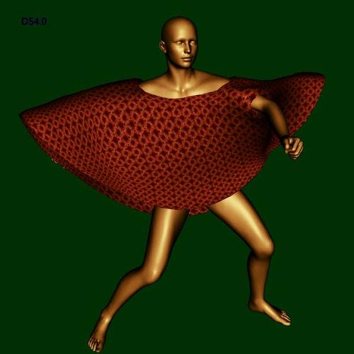

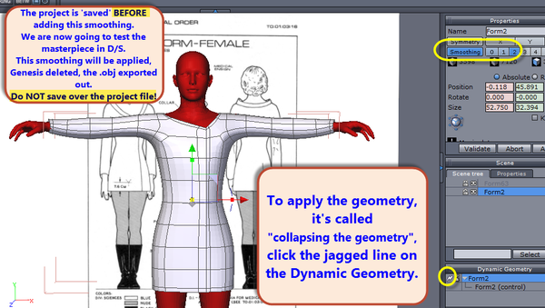

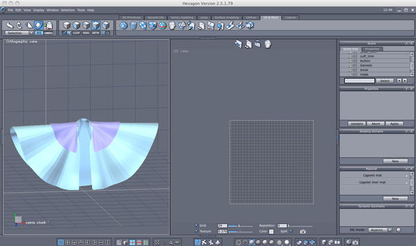

    I got started on my cloak last night, and pretty much have all of the modeling done, though I still need to collapse he geometry, UV map is, and assign Mat zones. Rigging this things going to be a pup though. I have no idea how I'm going to pull that off. I've started a WIP thread in the HExagon Discussion forum here.
    Anywhat take a look.
    1373 x 814 - 291K
    1373 x 814 - 234K
    1373 x 814 - 310K
    Post edited by Tramp Graphics on
    Looks like a good start!
    Rigging in D/S4 is much easier with the weight mapping and all. Should be possible.

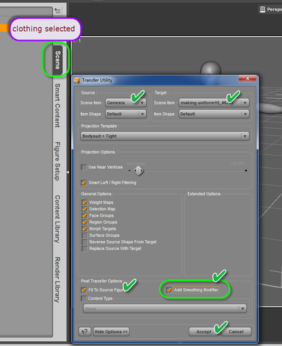

    Yeah, well the only rigging I've done is with the Transfer Utility, and have only just tried my first successful use of the Weight map feature. I really don't know how to use it. My very first attempt at adjusting weight maps (converting this to Genesis, and trying to fix the sleeves so that they'd move and drape properly) was a mess.
    Best of luck with the rigging. I'm having problems just rigging a small shawl, and that looks much more work.
    The basic rig would probably be very similar. The only real difference is this is floor-length.

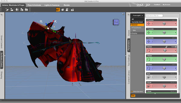

    I made a second attempt at rigging a circle shawl ... oh gee ...
    First try with transfer ... one arm worked, the 2nd arm didn't get the bones, etc assigned right ???
    Second try, different mesh ... well we got the bones. Deleted some, made a "handle" ...
    There seems to be quite a lot to learn with regards to applying "weight" ...
