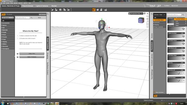

  • magaremotomagaremoto Posts: 1,238
    hello,
    I don't figure out what the problem can be with genesis in carrara; for morph issues you can save the scene in duf format taking into account this tip: save all the used morph parameters using the modifier/shape/generated type, as in attached screenshots, and carrara build 204 will import them fine. For animations I can't see any particular issue in carrara with the exception of dynamic clothes but a couple of guys here may help you easily. C4D is a great piece of software but the learning curve tends to slope immediately IMO

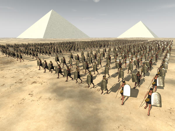

  • 3DAGE3DAGE Posts: 3,315
    Can one have larger scenes, with multiple Daz characters,
    I find this a strange question,.
    what size of scene are you looking for,. and how many Daz figures do you want in that scene,.?
    Also,.. what limitations are you finding,... if you're trying to work in carrara.
    That image was done in Carrara 6,. on a single core (32bit) system (Win XP) with 2GB ram,.. and much has improved since then.
    the replicators can handle more objects,. the lighting calculation is better, also,..there's no post production on that image,. and now Multi pass rendering in carrara can help you post process the image much better.
    Replicators are the key :
    Carrara can handle multiple figures,. and those can all have different NLA or key-frame animation (if you need animation)
    If you load a single figure,. add clothes and hair,. then select all of those objects and create a "group" or "animated group"
    it's easier to deal with when you add it to a replicator, or surface replicator.
    Make sure that the hot-point for the Group is at the base of the group, so it can be positioned correctly when you add it to the replicator.
    The replicators have some layout options,. so,. you would choose the type of layout you want and the number of replicated objects you want.
    you can also add an "Offset" value,. so that there's some variation in the positioning of the replicated objects.
    In C6,. I created three Michael 3 figures, dressed and armed them,. then made each (figure and clothing) into a group,..then added those three groups to a replicator to make 100 figures,
    I then added another replicator,. and added the First replicator to that,.. to make 10000 figures.
    Then I added another figure,. riding on an Elephant,. and some Camels. and those were added to another replicator.
    finally I posed the two main figures on the balcony, and set up the Sun and Moon lights.
    Carrara 6 had lower limitations on the amount of replicated objects in a replicator,. but Carrara 8 can handle 1000 x 1000 x 1000
    so, you could add an object to a replicator, to create 100000 of them,. then add that replicator, to another replicator, to create 1000000000, or simply Duplicate the first replicator as many times as you need.
    You also have the option of rendering things separately,. and compositing,.
    Bear in mind that it'll take a bit of time to calculate the instances before rendering, and the more complex your models, the more memory it will take to handle them.
    Using Lower resolution figures would be ideal for distant armies etc,.. where you wont see and real detail.
    hope it helps :)

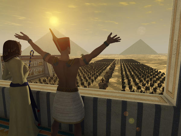

    PS. the image below was another test done at the same time in C6,. just to see what was possible and practical, using replicators to create an animated marching army. realism wasn't the goal,. pushing carrara, and learning what was possible was.

    I find your images super! While I myself often strive for realism, it can get too much of it too, it all depends on the story you are telling (if any). These days, I am not so occupied by realism at all, since I have discovered that my audience does not get the jaw drop effect by that, but insted by the story itself. I do animation, non-profit.
    I find the images, especially the first one with the Farao, just fantastic. It conveys a very special mood, and makes you think. It would be adequate for a magazine front page, covering historic events, or the like.
    I found Carrara's render engine more than sufficient for me, especially the lights/shadows were much easier to handle than in C4D.
    Hi Dartanbeck :)
    you're right,. buying an expensive car won't make you a better driver.
    those images were some of the first things I did here in Carrara, after finding it and the Daz site by accident,. ( I had been using 3D max) which comes with "no content at all" ..but some great tutorials to explain how to make your own models,. so,. I was looking for pre-made human figures, to save time,. then I found carrara,. had a look, and a play,. and realised that it's easier to use, with these pre-made figures, which max couldn't really handle well at that time (200 morphs per figure limit in max)
    so I jumped into carrara.
    for realism and comparison,. here's a pic from around the same time,. (when the elite textures were released)
    ..but going for a realistic look.

    I want to add a couple of comments on the Farao picture, the left side is perfect IMO, the beautifully decorated side wall, the dim fog and the slightly diffuse overall look - like a painting. What I like less is the multiple light sources on the right side, making the soldiers casting multiple shadows. These fight with the "early morning" effect that the left side has. Without multiple shadows for the soldiers, and withouth the lens flares, the impression of a beautiful painting would be perfect.
    It must have been a lot of work to make it.
    HI Ingvarai :)
    I can't take credit for the set,. it was a Prop from here (kings pass) and it was part of the Platinum club "weekly render challenge"
    http://www.daz3d.com/the-king-s-pass
    I think the hardest part of making that image was learning how the replicators worked with dressed figures,. (they need to be grouped together, and the hotspot for the group needs to be adjusted,. before adding them to the replicator)
    If I can find that scene,. I'll do a re-render in 8, or 8.5
