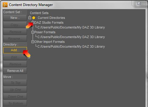

    File type is not the issue, not finding the saved data is the cause. Could you open this please... Content Directory Manager, then expand all paths in both Daz Studio Formats and Poser Formats and post a screen shot.

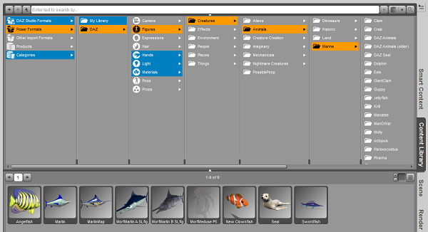

    Is this what you meant, Jaderail?
    (Content Manager came along about the time I had to quit from art for a while)
    basically my content all falls along the same scheme and out of the same folder system (which DS detected)
    c:\program files\DAZ\content\
    with the poser compatible files in
    c:\program files\DAZ\content\Runtime\ (etc.)
    with the various 'Figures', 'Poses', and 'Props' library folders organized as shown (so I can actually FIND things when looking for them)
    This library folder reorganization DOES occasionally cause issues with some 3rd party content that stores textures or .objs in the same folder with the content instead of in the respective \geometry and \textures folders - but not usually (and in the scenes I have done, only a couple of items has this occurred with on initial content load - though I selected the 'find file' option, the file and then the item loaded fine).
    is this what you wanted to know?

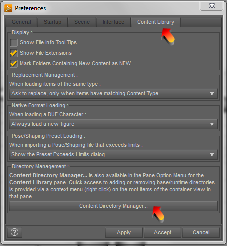

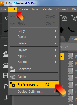

    You can just MOVE the folder to Documents and then remap the path in your DS prefs using the Content Directory Manager.

    494 x 357 - 32K
    454 x 492 - 44K
    259 x 352 - 24K
