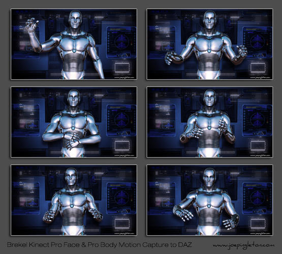

    Here is an updated Test.
    View the animation on YOUTUBE.COM by clicking here.
    View the Stereoscopic 3D animation on YOUTUBE.COM by clicking here.
    This is my second attempt with Brekel Kinect Pro Face & Brekel Kinect Pro Body
    I LOVE THESE PROGRAMS!
    … Sorry, I get excited
    Here was the easy process to go from a Xbox Kinect Motion Capture to DAZ Studio:
    1. Capture Body Movement with a standard Xbox Kinect sensor via Brekel Kinect Pro Body software.
    2. Capture Face Movement and Audio with a standard Xbox Kinect sensor via Brekel Kinect Pro Face software.
    3. In DAZ Studio, create a genesis figure.
    4. In Animate create a blank Aniblock.
    5. Import the Body Motion BVH into the base layer of the blank aniblock.
    6. In layer 1 of aniblock Zero the figure pose to the T-pose in the Motion capture.
    7. Import the Face export from Brekel Kinect Pro Face into a subtrack aniblock.
    8. Use the audio file from Brekel Kinect Pro Face in Mimic3 pro to generate a lip sync file.
    9. Import that file into DAZ studio.
    Enjoy and edit if you want.
    All I did was crop out the T pose frames and trim the end frames.
    Total Production
    Mocap and Importing: 30 min
    Rendering: 2 hours (got to love the genesis-bot textures)
    What do you think of the results?
    633 x 570 - 284K
    Post edited by Joepingleton on
  • jaebeajaebea Posts: 456
    I am going to be keeping up with you and your progress. Btw, doesn't Brekel Pro Face do mouth movements for the audio? I was watching a tutorial on it on YouTube and they had imported their model to match up and it was talking. I have emailed a question to Jasper (the developer) about importing our own models for blendshape matching. I am excited too!! Keep experimenting!!
  • JoepingletonJoepingleton Posts: 746
    Thanks for looking.
    It does do mouth capture but I liked the effect of layering it with mimic (I wish Lyp sync worked in daz studio 4.5 64 bit)
    There is definitely a lot more experimenting to be done.
    Let me know if you learn anything.

    I haven't had much success with Brekel pro body capturing walking, jumping or kicking.
    But I think that's because of the limitations of the kinect and my knowledge of its limitations.
    The problems seem to be staying withing the kinect's camera area. The sweet spot is about a stride forward and back and side to side.
    The only thing I have experimented with is running, walking and jumping in place. That seems to work much better.
    Plus I run into problems when joints cross each other, like in a typical fighting stance, you have to modify you movement so that your limbs don't overlap. I have gotten better results trying to capture them in side view rather than straight on. This techniques also seems to work better for kicks.
    This also leads to the main problem I can't seem to overcome is that of spinning. Since this obscures joints Kinect doesn't seem to be able to handle anytype of spinning motion. Maybe it there was two kinects and Brekel pro body supported them.
    I do like Brekel pro body for roughing motion in, but i suspect until I learn more there is a lot of key framing still needed.

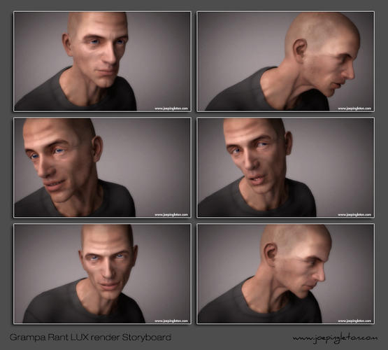

    edited June 2013
    Another test of DAZ Studio and Brekel Kinect Pro Face.
    Thanks for looking.

    This is my first test animation render using the Reality 2 LUX renderer from DAZ Studio.The Aniblocks and lip sync are from another experiment.
    30 seconds per frame render time @ 150 samples
    Thanks for looking.
