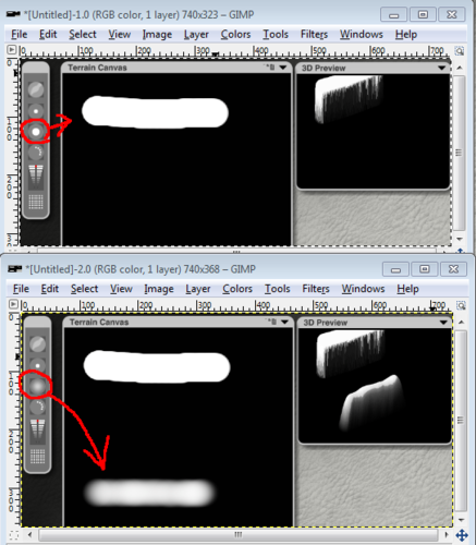

Have looked at tutorials. They are very good and got be started. I am trying to make a section of the Great wall of China. On thing was how do you precise make curves and straights in the canvas? Also what setting makes it perfectly straight up? I checked settings but could not figure it out. It always makes the sides slanted. I Used GIMP to do the test by drawing a wide line then one darker and narrower that it right down the middle. It sort of worked but the sides were slanted.

    Use the Hardness control. (Before painting on the canvas, click on it, then drag one way or the other until it changes.)

    @marinwestend - so you're using the Terrain Editor for that task. Good idea. However, it is tricky to get precise straight lines or bent lines with a particular radius. I recommend working with a graphics package, which may give you the desired result faster and easier.
    The important thing to remember is that what was drafted must be exported or saved as 16-bit greyscale TIFF. This picture can then be imported into the TE and further modified, if necessary. 8-bit pictures give terraces and are unusable in most cases. A 24 bit colour image is actually only an 8 bit (per colour).
