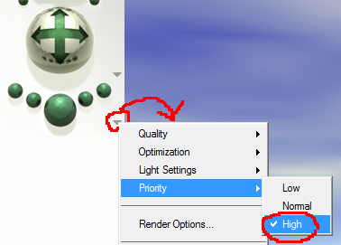

Make sure you change the priority to high to use all CPU cores. The default is normal, not high.

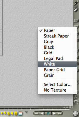

Background Paper: Select a solid color, not the default Paper background.

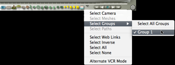

Selections: the right-most bottom tools are the Select By Category tools: from left to right you can select by object type, or family, or the reveal triangle has a lot of other categories you can select. The key here is that you can sharply increase performance by quickly hiding all the objects you don't really need to work with immediately.

Hi Ryan, you could try grouping the rollercoaster, or grouping different sections of it. Just select all the relevant parts then click 'G' from the little menu that appears next to the objects. Each group will then be listed and selected as such in the same way indivdual objects are. Bryce apparantely finds it easier to work with groups than lots of separate objects (and also renders quicker). This in conjunction with reducing the wireframe density might help. I have a quick run through of how this works here if it helps:
