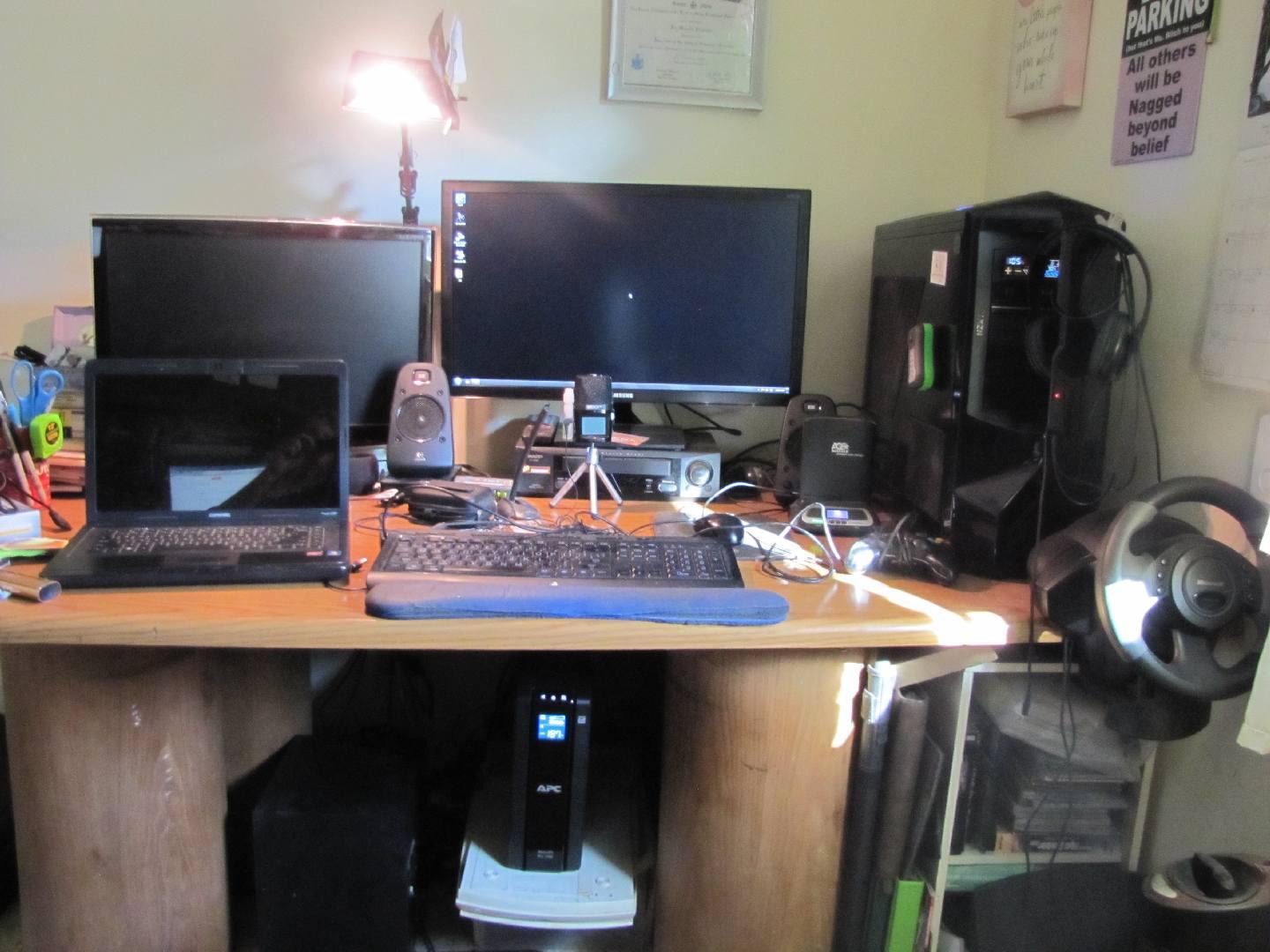

    yeah I don't have my laptop plugged into my UPS either for that reason.  just my render server machine .Its really a great gaming system and I just have to upgrade the companet not the system . this is my what my set up looks like minus the mess on the desk..lol
    Not too bad; my desk looks loads worse, which is why I'm currently using the kitchen table while I revamp my setup.
