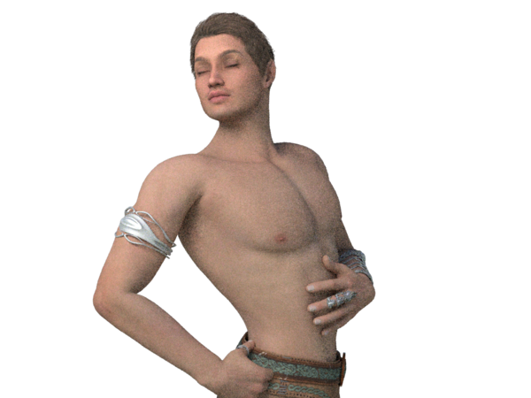

  • AdemnusAdemnus Posts: 744
    while I would never just use 1 light source, at least I might not have before, I just wanted a simple test.
    hairless, clothingless man standing in a simple pose; one spotlight.
    the first pic is using 3delight. the second, lux.
    Im in love.
    Granted, it took over an hour for an 800x5000 image and it actually wasnt done yet when i said, 'fine, thats enough," but I see the results are so striking I cannot wait to plumb its depths for all its secrets.
    800 x 500 - 85K
    800 x 500 - 55K
  • SotoSoto Posts: 1,438

    Tiny problem. I made the plane, as you said, ticked off the right boxes and buttons as you directed, and this is what I got.
    the second image is how it looks in preview. I tried it twice, second time I added white ambient to the plane thinking that was the problem, but both ended up with the same results.
