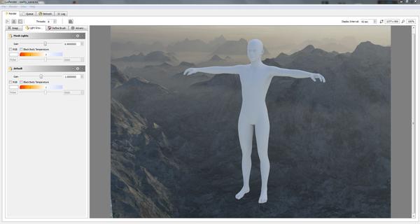

    The attached images show my settings for test render using Skybox1 from Top of the World...
    1914 x 1020 - 168K
    1900 x 1009 - 195K

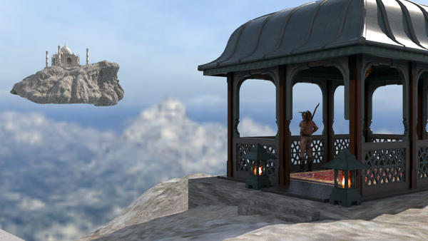

  • K T OngK T Ong Posts: 486
    And here's the render I did with the (unexpectedly) blurred skybox...
    1365 x 768 - 587K
  • JabbaJabba Posts: 1,461
    Aha, I never use a sun along with skybox. It would be a bit like sitting in a windowless room - it will still be dark even if the sun is shining outside. That would explain why everything had to be turned up to "eleven" :)
    Just "thinking out loud" so to speak, but maybe if the skybox meshlight has been boosted so much, the definition will bleed over, giving it a blurred look... I might be wrong, just trying to guess what might cause it.
    I pretty much always use the interior setting.

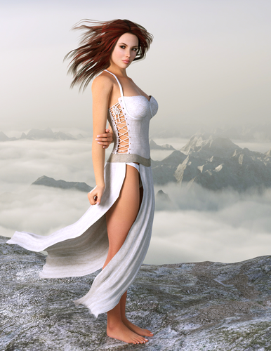

  • edited May 2013
    Here goes one of my first renders using the Top Of The World skybox with Reality-Lux. Following Jabba's advice, I converted the skybox materials to lights and turned gain to 4.00. I also added some mesh lights with gain set to 1.00 or lower. I'm quite happy with the result.
    Thanks again, Jabba! :-)
    1521 x 1968 - 5M
    nice one, but might get a chill standing there in bare feet for too long, hehehe
    ...for future reference, might be worth reducing gloss level on the rock surface underfoot - maybe something between 5000 and 6000 for a more natural dry look (or simply convert to a matte surface - this would help to speed up render time, but perhaps at the expense of 'feeling' organic).
