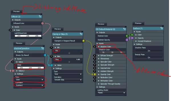

Hi,, there is good tool offered by Osomaki.
shadow catcher for AO shadow
it is powerful tool but you may need to use color picker, then adjust RGB color,,
I afraid you may not understand how to use this tool,,,
And tofusan show shader mixer recipi in his blog,,
but a few pic is not so family friendly,,, so I may not show link ^^; without his permission,,.
Tofusan and Osomaki mentioned on his blog,,, the recipi had been introduced in daz forum,
by surfdabbler , but when I checked the link ,I am missing the original topic,,,,
In my pic, I just added ds default material blick with surface ,from tofusan (surfdabbler) recipi
because I often get trouble,, when use surface blick without daz default material blick,,
but you may need not to add ds default material blick,
you can simply connect to input opacity of Root surface blick ,
without ds default material blick, from Clump or step out put value ( tofusan show the way)
And in my pic,,
labeled "shadow operation" blick,, is ,Function> mathmatics> " binary operation" blicks.
I changed name,
you need to set "binary operation blick" value = 255,255,255, . Operation = subtract.
then adjust shadow area and intensity by Clump blick, min and max properties.
I usually set min 0.0 to 0.25 and when I need more strong shadow,, change max value (usually 1.00 to 0.85 etc)

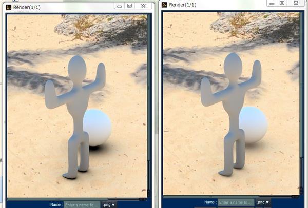

sometimes plane surface visible,,,,
it change which type of lighing of UE2 you use,
I think,, when use Occulusion w/soft shadow,
it make more clear black shadow with this shadow cathcer.
than Occulsion with direcitonal shadow. (I need more low value about max )
if you change diffuse color (daz default Material blick, diffuse color property,) it can adjust shadow color too.
eg apply medium grey or red darken shadow,,though you may need not,,,)

though it is not actuall effect from IBL,, but ,it make me easy to adjust shadow with surroundings maps)
