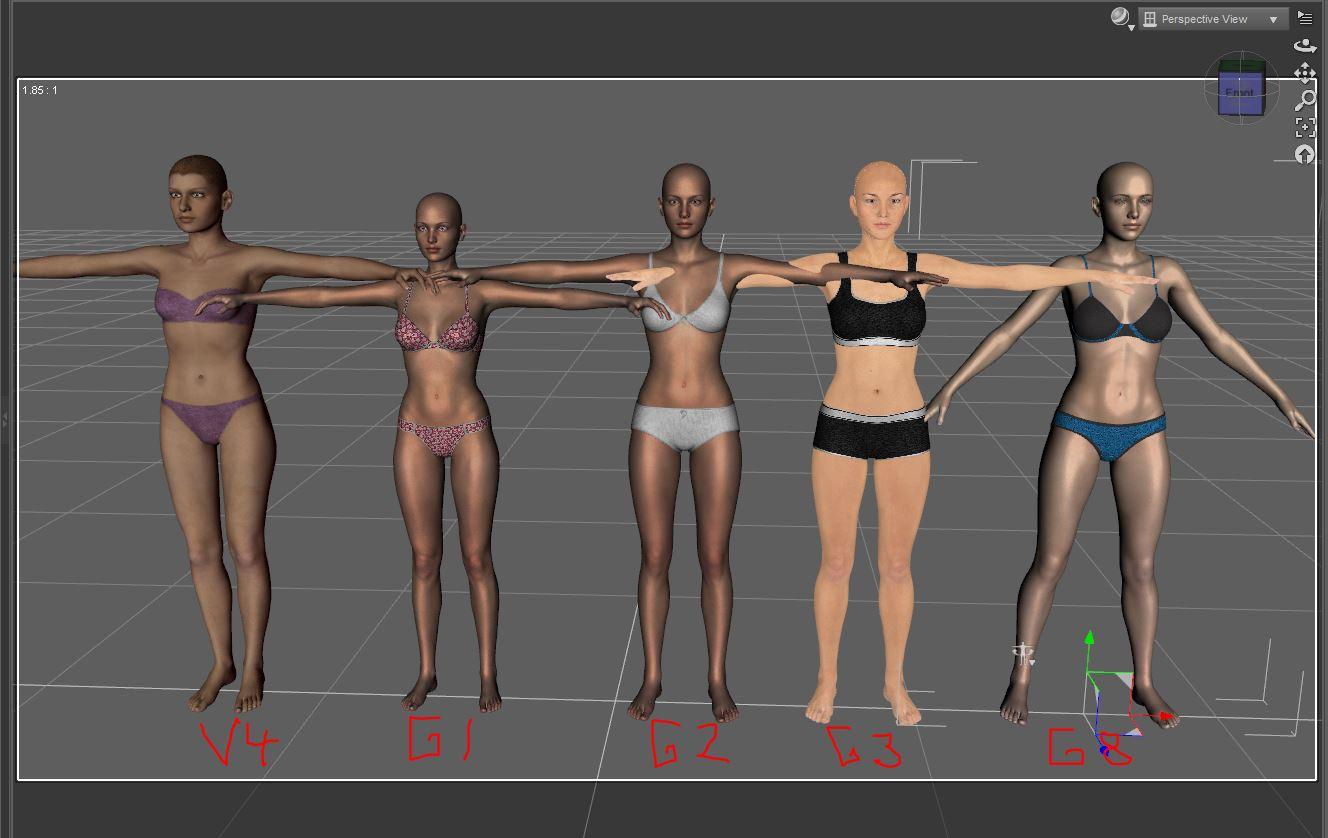

    The ladies in their base pose:

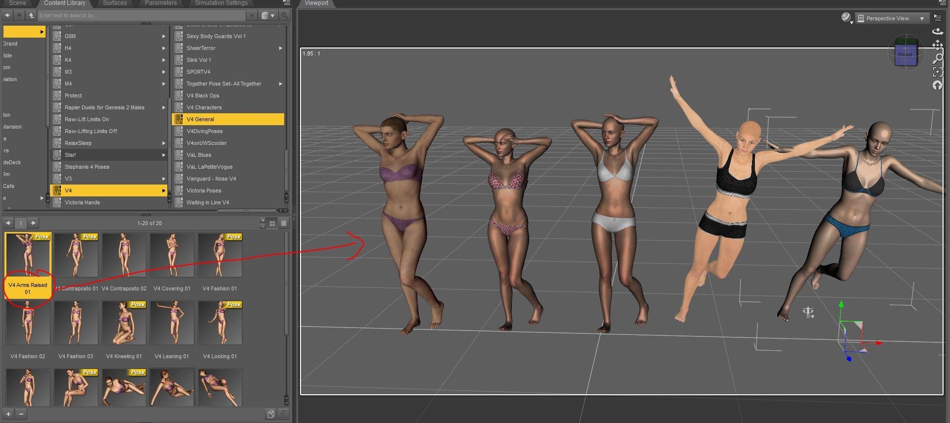

    Applying a V4 pose to the other generations: Slight hand/feet problems in G1 and G2, serious problems in G3 and G4

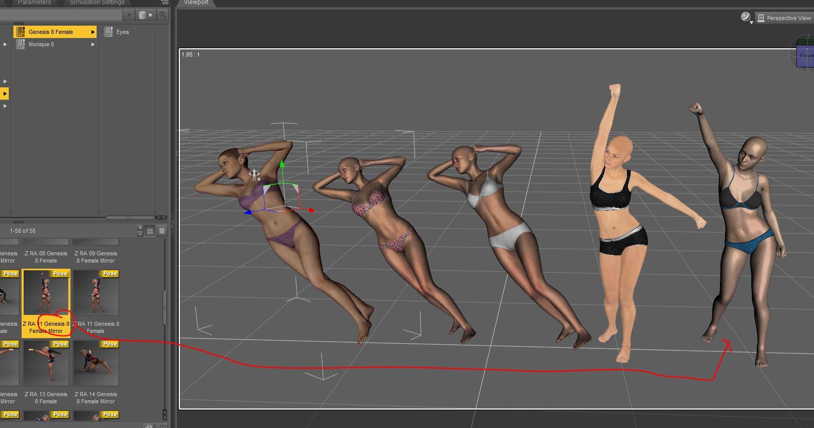

    Applying a G8 pose to the older generations: Much Mayham ensues in all the other generations, even G3, due to the different base pose of G8.

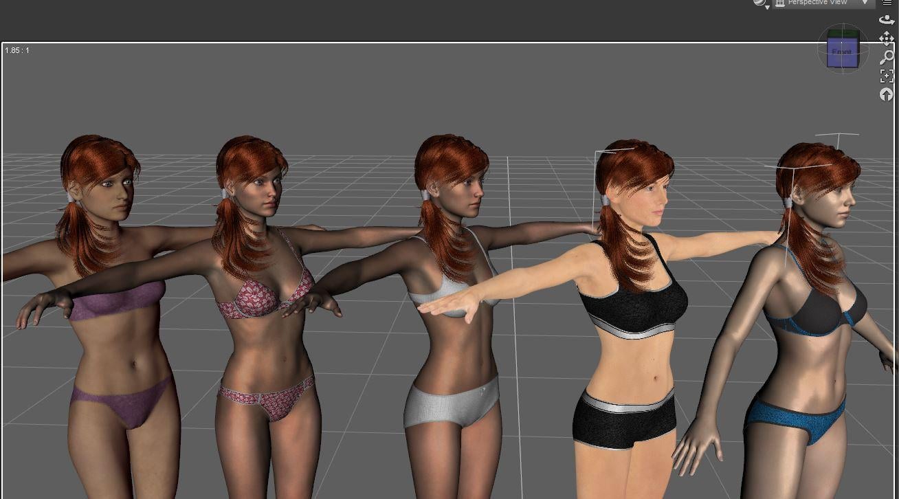

    Hair: As long as you remain in base pose, hair usually translates pretty good between generations. Here's a V4 long hair. The problems start when you move the figure, as you'll end up with distortions.
