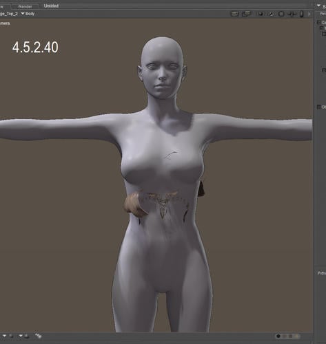

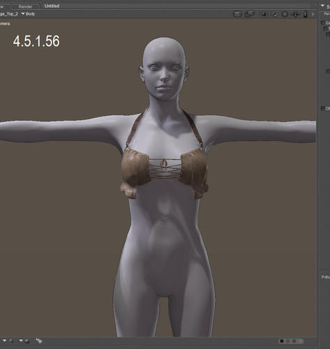

Hi everyone. About the problem:
I want to convert old clothing from V4 to genesis, save it as support asset and use it in Poser.
So in DS 4.5.1.56 i just did usual conversion process and then "Save as> support asset > figure/prop"
then found it in library and create Poser Companion files. done. All works in poser.
With 4.5.2.40 i do the same but get strange result (see attachment)
when i create "wearable preset" it works in poser. But I need to save as Figure asset.
Have anyone encountered same bug?
i'm using older version till the bug is fixed
1017 x 1076 - 120K
1017 x 1076 - 125K

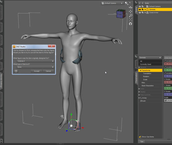

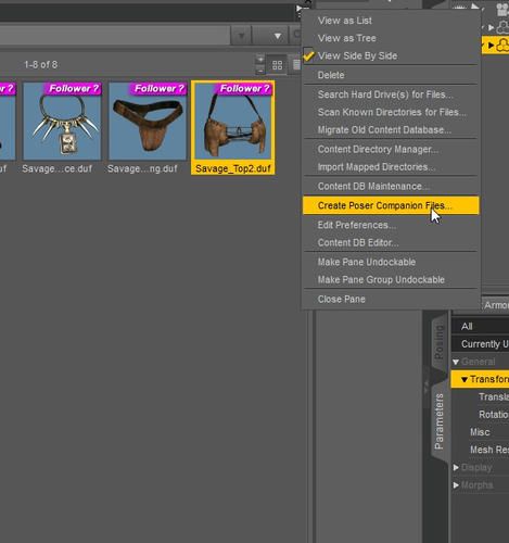

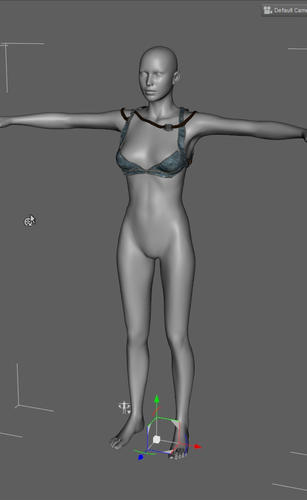

    I havent reported this issue
    I posted screen caps step by step. Overall mostly all default
    578 x 616 - 86K
    476 x 723 - 72K
    737 x 817 - 154K
    574 x 935 - 52K
    1133 x 950 - 165K

    So it's working in DS? Are you saving as a Figure Asset, then saving a wearables preset? I'm not understanding the "when i create “wearable preset” it works in poser. But I need to save as Figure asset." part of the original post.
  • edited December 1969
    Ok. Again. This bug appears in DS 4.5.2.40 ( the new BETA update). When I save as Figure asset and then (after creating poser companion files) in Poser conform it to genesis - the bug appears. Non conformed stated is normal, no strange deformations on clothing.
    If I save same clothing as wearable preset and confrm it to genesis in poser - all good. (but wearable preset is not what i need)
    In DS 4.5.1.56 there's no such bug with saving as Figure asset. Clothes works fine in poser.
    My opinion - not sure if the problem really IS in saving. I suspect the problem is in auto-fit convertion.
    Well, maybe I just dont know about some changes in workflow but for now it looks like a bug.
