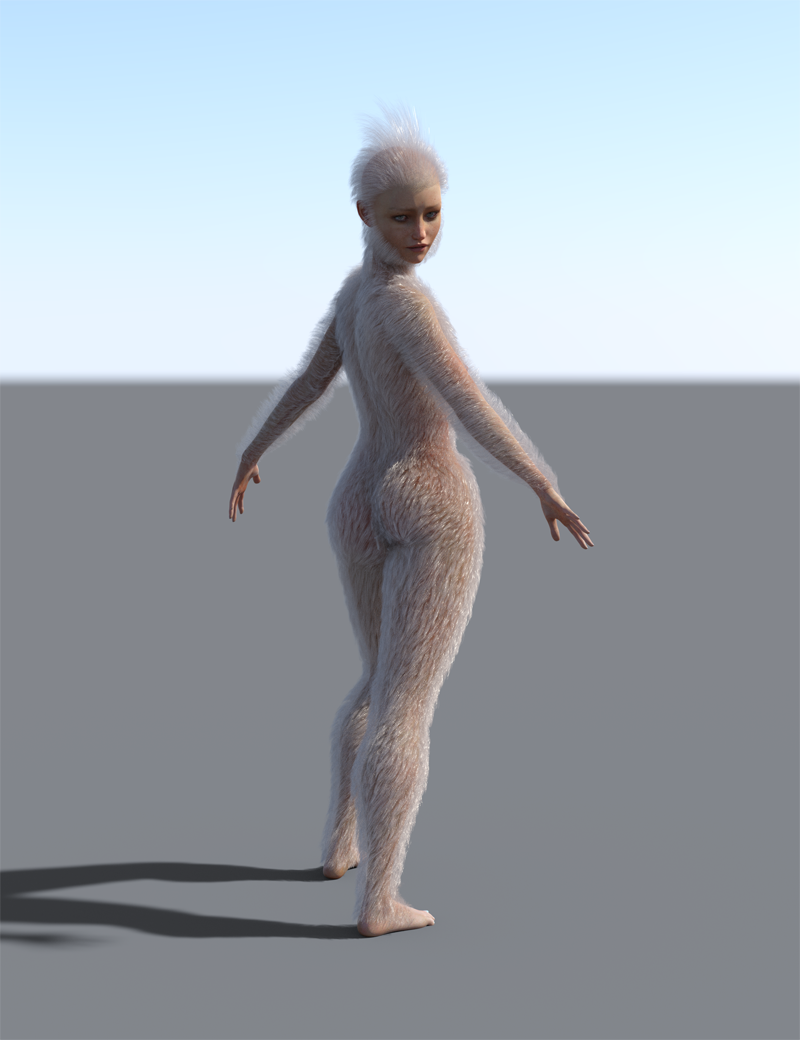

    I don't think there's any way to transfer the preset (please anybody correct me if I'm wrong!), but there might be another non-ideal way to get the hair on a G3 figure. You might try loading Squatch, dialing out his shape and dialing in G3F/G3M base shape. Export the hair as OBJ and, after re-importing, load a fresh G3F/G3M and use the transfer utility. You should then be able to apply morph shapes/poses to the G3 figure and the hair should follow (though probably not perfectly).
    Tried this using Darwin as I don't own the Squatch - both the OBJ export and the transfer uitility took a while to run, but did eventually finish. Manipulating the figure at this point was slow (as is to be expected since the hair is actual geo now), and of course the shading needs to be addressed.
    Anyway, here is a test render of some albino chimp hair on a posed G3F with a custom morph:
    Fun exercise, and she came out looking pretty warm and cuddly if you ask me! The ultimate Snuggie ;)
    - Greg
