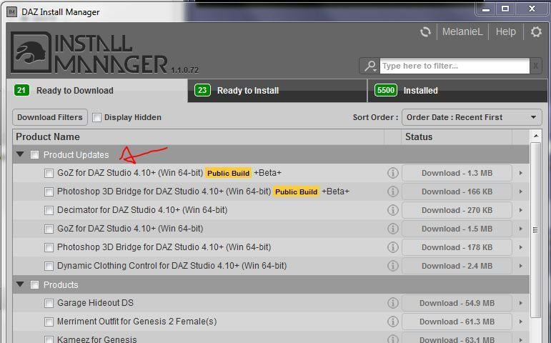

  • MelanieLMelanieL Posts: 7,865
    edited November 2017
    Atanacius said:
    @Fixmypcmike, your method is very efficient, but.. where I can see in "Installed" tab in DIM the term "There is an Update for this Product", since, all I can see for the product I tested is "Uninstall" ?
    ​Otherwise, for listing, it worked greatly!
    Thanks again, I will waiting for your answer !
    In case Mike is not around for a while: no the updates will show up under the "Ready to Download" tab in a section at the top labelled "Product Updates".
    771 x 480 - 72K
    Post edited by MelanieL on
  • MelanieL said:
    Oh Superb, it works !
    ​Thanks also @MelanieL :)
    ​Have a nice day !
