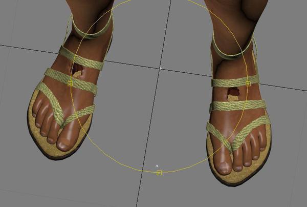

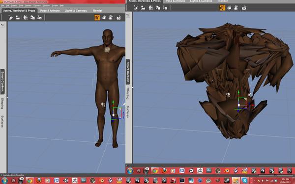

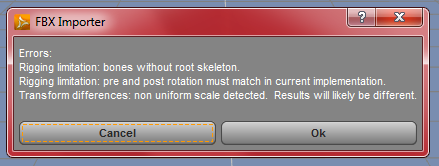

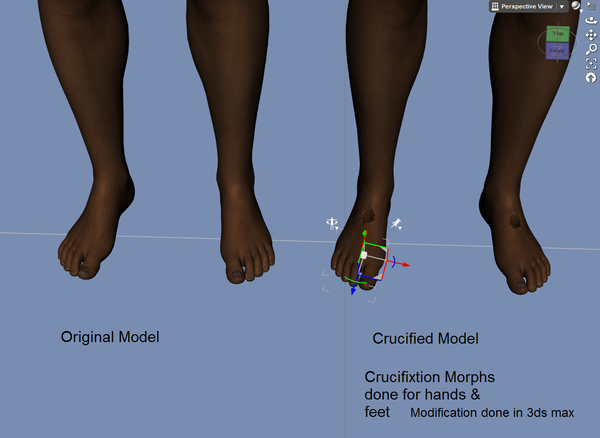

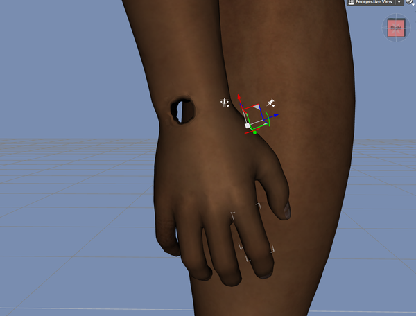

    In the picture added, this is what I've done I added crucifixion wounds to the mesh, I did it in 3DS Max. When I re-imported it the problem that is displayed in the first picture is happening. & by what has been said in the posts prior I tried following it but that's where I'm stumped. I thought that I could load the original and just copy of over the rig to the new one but that didn't work. So what do I need to do?
    EDIT: Yes the model was exported as FBX in to max.. then re-imported into DS. I've even tried exporting it as a obj so i could load the morph but that didn't work, and the transfer utility doesn't transfer over properly, it only gets worse actually.. so it's not morphing as it should like the original model on the left.

    @Kitakoredaz, Basically as displayed in the pictures I've created holes using 3dmax. we understand that. Now from what I understand is that your saying the Genesis model may not work as it should, but im trying to find a work around so that it can work. I'm not sure how to fix the bones and weights properly so that it works as it should. I'm having trouble when I use the transfer utility, the morphs and weights etc dont transfer properly so thats why the results of the first picture is happening.

    then could you save he hole as morph?
    I know,, you made hole by 3ds,,,
    but if you simply import it to ds as FBX or obj, wihout using morph loader?
    Can you see actuall controller to make hole as same as other morphs of genesis in ds parameter?
    and it can work as you plan?
    I can not believe to make such clear holes without changing vertex counts , vertex order.
    of course I can make holes by 3d tools, but if I change vertex order and counts,
    the new shape can not become morph of original.
    so that morph loader may send erroer message
    when I try to apply the holed shape to original figure as morph.
    If I make hole morph,, I may need to make transparent texture the hole area. (but the mesh have no hole actually,
    just change scale down ,,)
    transfer utility can transfer "morphs" of donner figure to target figure.
    but if target is simply another shape (with hole), it can not transfer the shape to target.
    just transfer rig and weight-maps to target. (and I said it may not perfect)

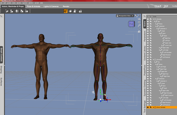

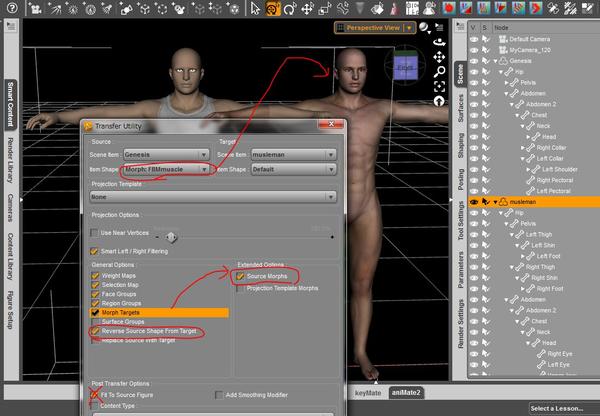

    Is the settings right? by the way look at where it says "figure_genensis" it only has one bone title as hip but its the mouth area... could'nt I just cut off the wounded feet and hands and put them on the other model to the left cuz they are the same model... I wil have to buy those books from the daz webstore.. but for now do i have the right settings?

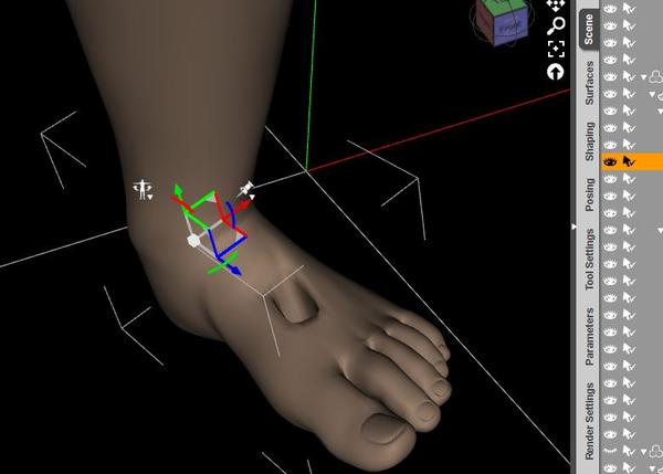

  • majesticcreationsmajesticcreations Posts: 107
    edited April 2013
    Isn't there some way to take the donor rig from the original of the left and bind it to the one on the right???
    EDIT: also what I find strange is that when I extract the donor structure and try to save the scene I cant. for some reason an error occurs :(
    EDIT2: I was able to get them merged together some how dont really know how it worked... BUT, it still does not morph properly when moved around also leave it for a few seconds and it explodes some how,look in the picture... what the hell is going on???

  • kitakoredazkitakoredaz Posts: 3,526
    edited April 2013

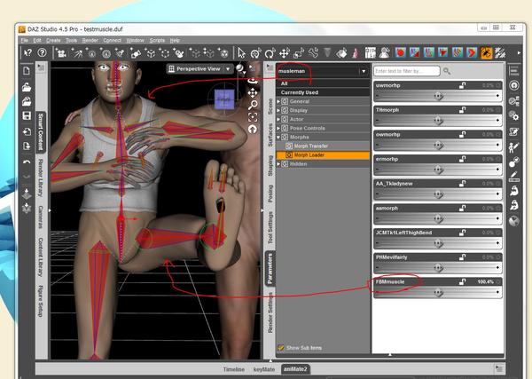

    how you make your base donner figure?
    if it is genesis daz original, (not changed to general weight or exported and import as FBX etc)
    and you made the male shape by poruct morphs it may work.
    I tried some test,,
    1. make men shape by product morphs with genesis.
    2. export the current mesh shape to hexagon.
    3 I modify them then make hole his uncle.
    it must change vertex counts, etc. then I know, it can not be morph of original genesis.
    the obj shape break uv maps ^^; but if I hope so,, after use transfer utility,
    I can apply morph again. and may need to set UV maps again.
    I do not know there is way ,to keep UV (not break) but making holes.
    anyway I save the holed muscle man shape as muscle_hole_obj.
    4 I import the obj to ds.
    5 I use transfer utility ,then export surface gorup , rig, weight map, from genesis.
    I choose option,,
    Source item = genesis , and item shape curren.
    Target item = muscle Hole obj , and item shape default.
    and check out morph target option ( at this time,, I may need not many genesis morphs for this figure,,)
    and No need to Fit to Source Figure,, So I check Off
    then check rig move only. my hole was actually bad (I did not modify much, do not bevel around hole etc,,)
    so that I apply sub-D, then up resolution level.
    If I hope the new muscle can be use as same as genesis,
    (use same wear,, and use moprhs of genesis,)
    there need another steps. it means make almost same shape figure as orignal genesis zero shape,with holes.
    I made it too. it can wear clothing of genesis.
    1 first make FBM which can change genesis shape to current muscle shape.
    (simply export current shape as obj then re-import by morph loader,, then make new morphs.
    it may not ift perfect curernt shape, but I need transfer rigs and use reverse option,, so now I need not adjust rigs)
    2 zero figure genesis, then apply the muscleFBM,, it must change genesis shape to muscle shape.
    3 import again the hole muscle man shape as obj.
    4 use transfer utility
    Source item = genesis , and item shape current (it can record only one morphs which used for genesis, I think)
    check on morph target option, then use reverse source from target.
    it transfer all morphs of genesis, (muscle morphs too)
    to hole muscle man, then reverse the shape almost like genesis zero shape. (with hole)
    so you need apply the muscle man morph again to your new figure.
    it can wear genesis clothings, and have hole in his foot,
    and can apply same morphs (not perfect work I think,,)
    but I need to make uv map ,,then may need to use transfer utility again,,to copy rig and weight map,,
