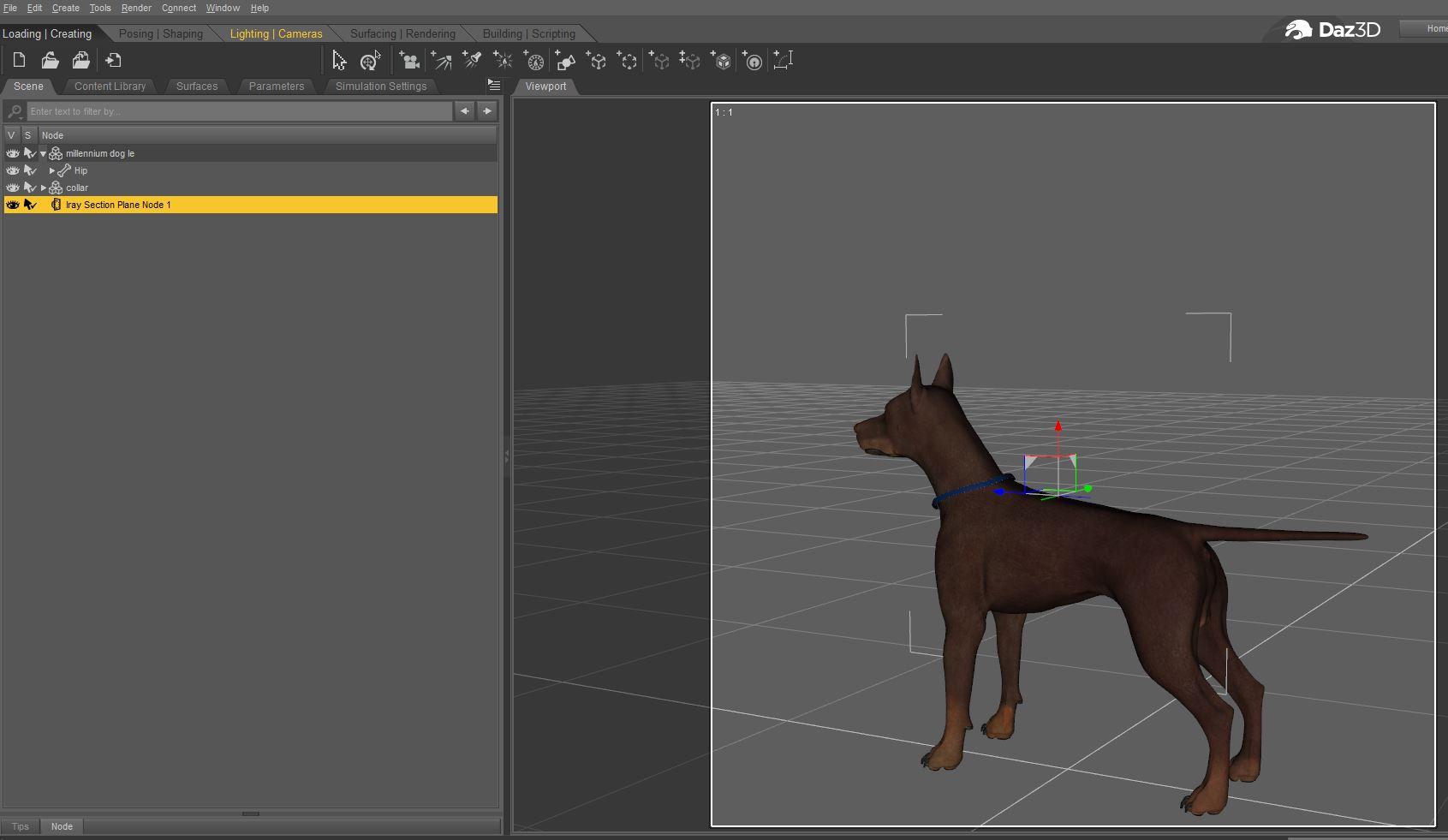

If youuse Iray and just have the dog and the collar in the render, there's this very nifty trick using the Iray Section Plane Node. It doesn't render things that are behind it, and you can ise the direction of the node to tell it if it should hide things before or behind it.
You create a node by Create-->New Iray Section Node.
You then select ithe Section Node in the scene tab. If you have the multi-tool activated, you'll see the directional arrows; everything in direction of the green arrow axis is hidden. If you change the x-angle to 90 degrees, and pose the Sectio Plane node in the mide of the dog, it will be cut in half. If you hide the dog, you'll just have the half collar.

This looks like it will work for what I am trying to do. Nice! I also found a way to do it with canvas, but it seems like yours may work better. Thanks!
