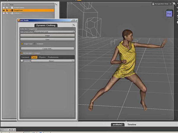

    I still don't understand what it has to do with animation.
    I did this in one minute.
    - loaded V4
    - loaded dynamic cloth
    - gave a random Genesis basic male pose
    - no fiddling in the Dynamic Clothing panel, just hit 'Drape'
    1200 x 900 - 130K

    Two main reasons that works. Firstly, your garment has no sleeves, and so doesn't clip through the arms. If it had been a sleeved garment, the sleeve would start out inside the figure, and the subsequent drape would be colliding as such. Secondly, the clothing is a simple dress and can sit upon the legs at the bottom.
    In an animated drape, you might get some level of stretching at the legs instead of it riding up, and it would look more natural.
