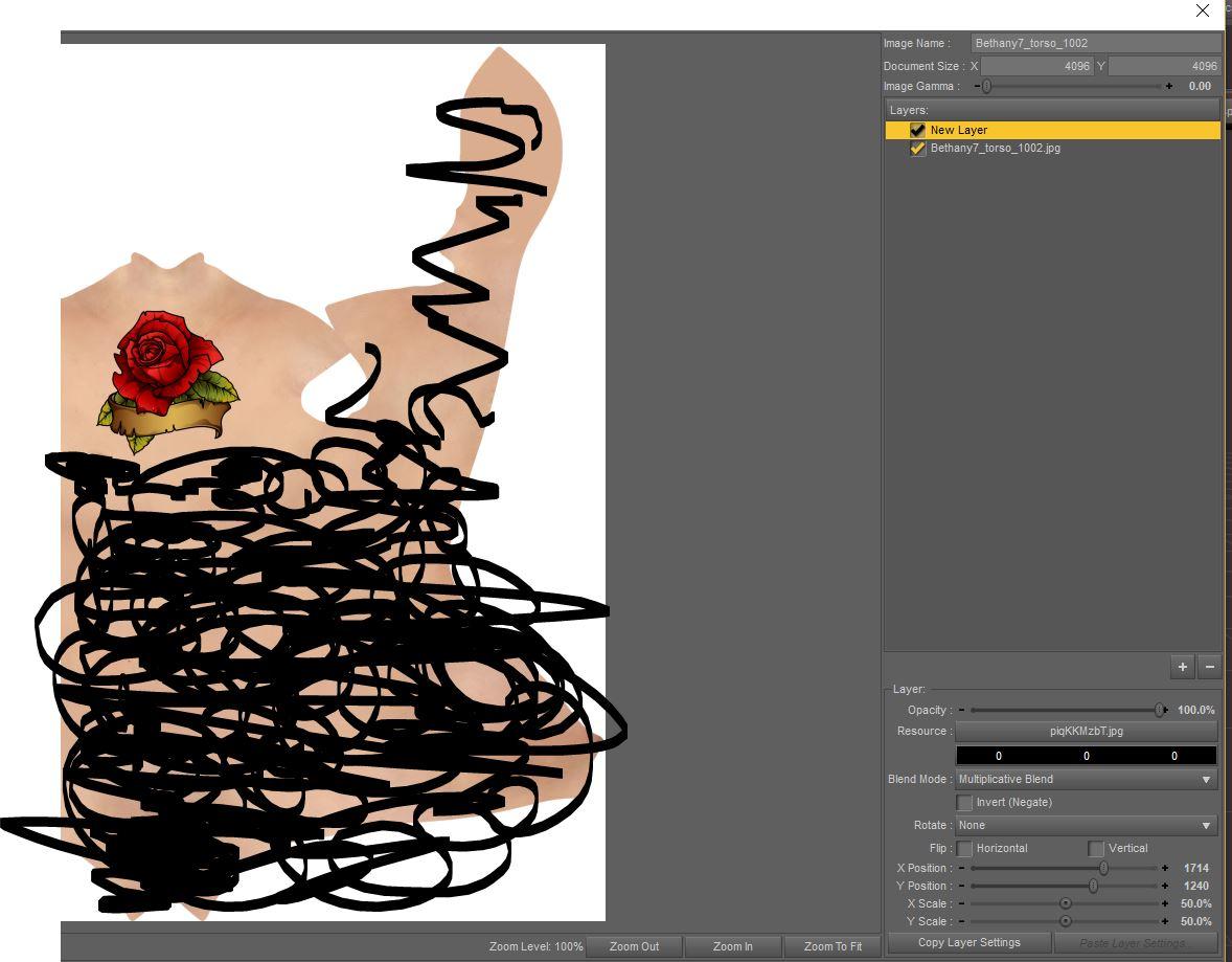

    Here's how you can set up the tattoo (assuming that you already know how to work with the LIE editor):
    First, create a second layer in LIE, and load the tattoo image to it (mods: I hope the skin texture was edited sufficiently?).
    Make sure you use the multiplicative blend. AT this example, the opacity (at the bottom of the settings) is set to 100%, but that comes out as pretty strong. A lower number is usually better; you need to experiment bit to find the proper strength for your tattoo.
    If you are done with your changes, the rendered image looks something like this:

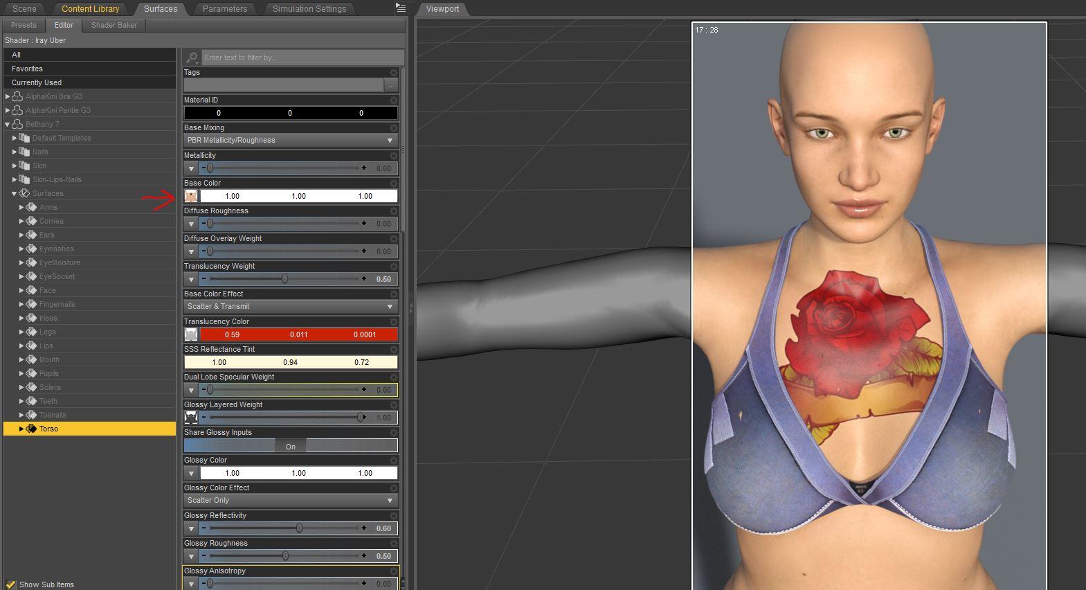

  • Thanks for the info, Bee! I had originally tried the Base Color but it barely showed up. I went back and tried it again with the info you provided. What I learned was that other settings appear to be causing the problem. I am working from a Victoria 8 figure just using the materials that come with it.
    I looked at the Surface pane screen shot that you attached and tweeked my Translucency Weight down to 50% and the Tattoo popped into view. So, it appears that there is something problematic with the Victoria 8 defaults.
    One other thing that seems odd is that the my Translucency Color was 1 1 1.  Yours is quite different.
    I have attached my Surface settings to get some feedback on what they should be.
    Thanks!

    I've checked out the G8 tattoo problem, and it seems it's due to G8 having dual lobe settings.
    The solution is pretty simple. You add the tatto to both, base colour and translucency colour. They have to match positions, so you best note down the x and y coordinates along with the scaling.
    Here's the tattoo test render at 100% strength of the layer and multiplicative blen on default V8 materials; I'd suggest you test with the strength of the tattoo layers until the result fits your purpose.
