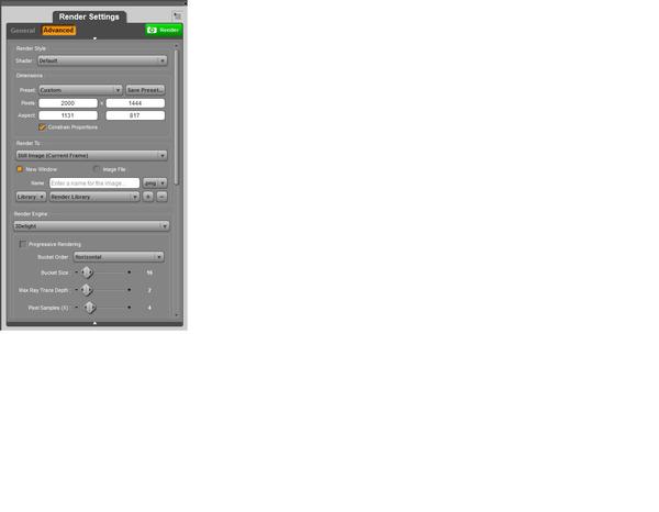

    Both the program and the computer have been rebooted several times, I even ran a scan of the entire computer, software and hardware and no faults were found. The last time I got an error, another window popped up stating there was a fatal exception error and it was one of the dll's in the system 32 folder. I attempt to save the information to show what it said (I didn't understand it at all), but the program crashed when I tried that, closing without warning. I wish I had a quad core, but I don't. Computer specs are in an image below, as are my Daz render settins and the main warning I keep getting. I tried to recreate the other warning but Daz won't give me that either. I am wondering if I should uninstall and reinstall except I do not look forward to reinstalling the content, it's a pain to have to keep doing that.

    my bucket size was set to 8 when the problem first appeared. I am always cleaning stuff off the computer, the harddrive is not the terabyte my son has...lol...so have to constantly free up space, I burn every thing to disk so I always have it and keep the computer free. I recently installed Antivir antivirus program and I wonder if that's what's causing the problem. Had AVGt on but lately that had not been working like it should.
    I see from your specs that you only have 2GB of RAM, and the error message mentions a memory error, that is the problem I think.
    You only have 2GB of main memory, and the OS uses a lot of that to begin with. Sorry for the bad news.
