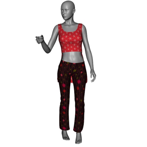

Free Clothing Prop For Genesis Female!!!!!!!!!
DigitalPimpinDigitalPimpin Posts: 33
edited April 2013 in Freebies
This is my first self made outfit, and I'm excited to have another freebie to offer back to the community! I am a newbie so please give me feedback so I may learn and grow. It imports as one object but will separate if that's easier for you guys, just let me know if you want it separate so I can re-post. Daz4 users use transfer utility after import
http://depositfiles.com/files/r580mfhq3
770 x 885 - 196K
Post edited by DigitalPimpin on

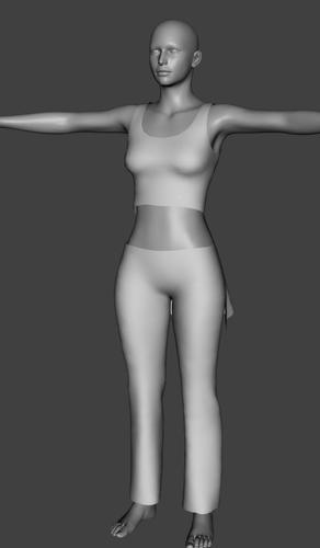

  • BejaymacBejaymac Posts: 2,002
    Getting clothing from things like MD to work right is a problem for most, but for someone like me who makes his own content it doesn't take too long to get things to work half decent in DS. The attached pic is your outfit conformed and rigged to Genesis, to get it like that I dialed up the basic female morph in Genesis, then I used the Transfer Utility to reverse the source shape, the result of that was an outfit with a lot of wrinkles in it, so I applied a smoothing modifier, set it to Generic and the smoothing to 30 to get rid of them, I then "baked" the smoothing modifier and exported the smoothed mesh as a new OBJ. After deleting the old outfit from the scene I then imported the OBJ I just made, and rigged it with the Transfer Utility, I also used your mesh as a Morph Target to create the Basic female morph, and smoothed and baked it for a better finish.
    Would be better if I was to split the top from the pants and have them as separate items, but it's not too bad for 10 minutes work.

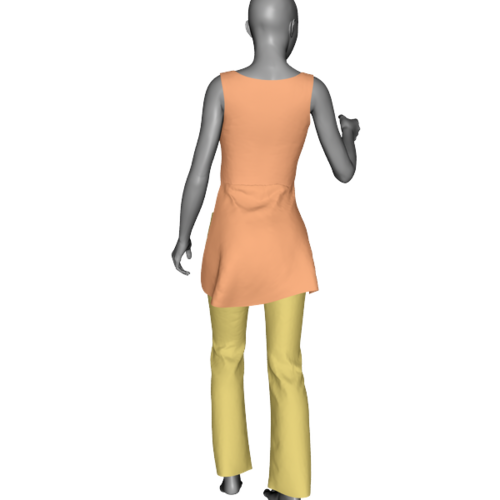

  • WilmapWilmap Posts: 2,917
    edited April 2013
    Well I had to re-UV map the textures first, but I loaded the object into Daz at 100% and it came in the correct size!
    I then shaped Genesis to basic female and ran the transfer utility and it worked fine. Shaped Genesis to V4 and apart from the bust not being as smooth as I would have liked, it was OK.
    Just one problem area, and I find this in a lot of MD clothing - the back has a large ruck which need smoothing out in a modelling program.
    Otherwise a good first attempt.:-)
    Here is an image to show what I mean.
    600 x 600 - 148K
    600 x 600 - 113K
    Post edited by Wilmap on
