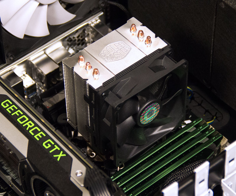

    Well, you asked for it.............When I need data, I like to go to my good ole' friends, Puget Systems.  They have been doing professional tests like these for years.  Read what they have to say about their tests on this topic.  Keep in mind, they were using desktop systems, but the same principles doubly apply to laptops:
    Is stock cooling adequate?
    "While the information from the previous section is really interesting, it may be hard to translate into a real world situation. To help with this, we performed the exact same Linpack test except that instead of altering the cooling manually we used two different CPU coolers - the stock cooler that came bundled with the Core i7 4790 and the budget-friendly Cooler Master Hyper TX3 which only costs about $20. To make this as real-world as possible, we installed our test hardware (Asus Sabertooth Z97 Mark II, Intel Core i7 4790, 4x Kingston HyperX LoVo DDR3-1600 4GB, NVIDIA GeForce GTX 980) into a Fractal Design Define R4 chassis with the stock fans running at 5V.
    Intel stock cooling
    As you can see from the graph above, even a very affordable CPU cooler like the CM Hyper TX3 is able to dramatically lower the CPU temperature under load. While the stock cooler is easily hitting 100 °C during the benchmark run, the CM Hyper TX3 only ever hits a maximum temperature of 80 °C. In terms of how much the CPU was overheating, the stock cooler allowed the CPU to run at > 99 °C about 20% of the time. "    [end quote]
    This data certainly backs up what I said.  Some stock systems are not designed to keep the insides cool enough for comfort under continual heavy loads.  Then the writer goes on to say why this could be a problem (the bold print is mine):
    "Frankly, we were a bit surprised at how well modern Intel CPUs dealt with really high temperatures. They manage to run at full speed all the way up to 100 °C, and even then the performance is not greatly affected unless they spend a significant amount of time at that temperature. We certainly don't advocate letting your CPU run at those kinds of temperatures, however. While this article is about performance there are plenty of non-performance based reasond to keep your CPU temperature at a more reasonable level.
    Sensitive electronics like CPUs have a finite lifespan and running them at higher temperatures shortens it. So unless you want to have an excuse to upgrade your system often, higher temperatures are counter-productive.
    With PC hardware, higher temperatures make both minor and major hardware faults much more likely. These hardware faults can result in anything from reduced performance due to minor errors needing to be corrected to data corruption or bluescreens due to more dramatic errors.
    The difficult thing is that just saying "lower temperatures are better" is an overly simplified way to look at CPU temperatures when you consider a PC as a whole. While you can use giant liquid cooling loops, insanely high flow fans, or even things like liquid nitrogen to keep a CPU extremely well cooled those methods are either expensive, cumbersome, loud, or a combination of all three. In reality it is generally better to let the CPU run a little warm in order to properly balance the cooling against the heat output of the CPU.
    CM Hyper TX3
    For example, the Corsair Hydro H60 is a great closed-loop CPU cooler that we use on most of our high wattage CPUs, but it would be overkill for a low-wattage Intel Core i3 CPU.
    It would certainly keep the CPU well cooled, but it would be much louder, more complex (due to the liquid and pump), and more expensive than what is necessary. Instead, a CM Hyper TX3 or Gelid Tranquillo (if you want to have the system even quieter) would be a better match for that CPU even though the CPU would run slightly hotter under load."
    [end of quote]
    The writer of this article says exactly what I have been telling you.  Almost verbatim.  3D rendering ain't normal use for most people.  It can wear out a lesser machine.  These guys have been doing years of research like this.  I doubt if they are overreacting.  Source: https://www.pugetsystems.com/labs/articles/Impact-of-Temperature-on-Intel-CPU-Performance-606/

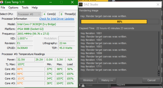

    I think then according to what you wrote we are wasting our time, appartently with intel Gen 3 i-core CPUs and newer looking at CPU temperature because they've improved the turbo/throttle to such a degree that they can't overheat.
    I noticed that even though 3 of 4 cores reached 104C or 105C on my CPU the actual wattage that I saw in Core Temp only ever maxed out at 37.9W and this CPU I have has TDP of 45W. Unfortunately Core Temp does not save the min watt and max watt of the CPU being monitored like it does the min and max temperatures of the CPU.
    My render times per frame after the initial 1 to 15 minutes for DAZ Studio to set up the scene for the 1st iteration iray write are very consistent, even though 3 of 4 cores go up to 100%, and the temperature stay consistantly in the 90Cs sometimes getting to 105C. I think to burn out my CPU I would need to drive the wattage to exceed 45W and I think the modern intel i-core from Generation 2 and onwards won't allow exceeding the TDP.
    You can log the results of core temp in a file though to find the wattage used on Core #0 which is most of the wattage used by the CPU package. It is the 2nd to the last entry before the timestamp.
    The max time for a DAZ iray iteration you can find by running a grep, cut, and sort on the DAZ Studio log file if you have UNIX utilities on your Windows machine since you said you don't have Wine & DAZ installed on your Linux machine.
    Core Temp itself reads directly from CPU registers and shouldn't be habitually used once you are satisfied with the performance characteristics of your laptop.
    So my thoughts directly to your question is based on my laptop's performance: it is running a turbo / cool cycle so quickly and efficiently because it was designed that way so that the CPU won't fail even with frequent renders although as I mentioned earlier other components will eventually fail from long term disappated heat without a regular cool down cycle for the laptop such as shutting down daily for a few hours. So I can say that the HP 8460P will fail with frequent renders and no shutdown time daily for a few hours to cool off as I've had one and it's failed in that way already. The CPU on it didn't fail though, something, likely the connections at the graphics i/o controllers failed. Given the HP 8470P is nearly identical I'd expect it to eventually fail in the same way with the same usage patterns. Other laptops too as those designs aren't significantly different except the meatal chassis of the HP 84XXP series is likely to disapate heat better than a plastic chassis.
