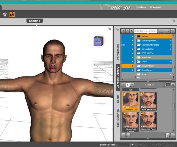

I'm trying to transfer an M4 character to Genesis but something is going wrong with the skin.
I transferred the morphs using Gen X - they transferred okay. Then I dialed 100% M4 from the iconic shapes. This was tried with Basic male once at 100% and once at 0%. Then I dialed in the Samson morph to 100%. Then I double-clicked on the texture in the content window.
This is what happens:
What am I doing wrong?

    Go to your surfaces tab, select the skin surfaces and where it says "UV" change it to M4. That should do the trick.
  • SGCBearcubSGCBearcub Posts: 243
    That did it! Thank-you.
    You'll find this happening with any non-Genesis texture, the material file you click on doesn't include the Genesis setting that changes the UVmap so you have to do it manually.

    Hello I am having the same issue and am looking for the UV option on the surfaces tab, but I don't see it. All I see under the Surfaces for Genesis under "All" are several sample options and wetsuits. Any help greatly appreciated!
  • fixmypcmikefixmypcmike Posts: 19,738
    On the Surfaces pane click Editor at the top rather than Presets
