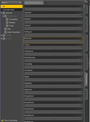

I could swear I saw a thread on this ages ago but I can't find it (may have been lost, may have been in the Member's only forum) but what is going on with the morph list for Aiko 3 in DS 4.5.x?
It looks like I'm needing to drill down to each body part to apply morphs, and even then, everything is grayed out and most of it not working.

    Click on "All" in the Parameters tab

  • JaeAlexisLeeJaeAlexisLee Posts: 11
    This is what I get for thinking it would be in the shaping tab.... thanks!
