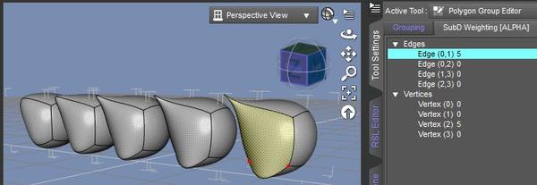

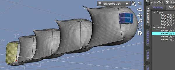

Okay, I've been testing OpenSubDiv (OSD) edge creasing.
And I'm thrilled by it...
I have discovered one thing interesting. If you have your subdivision level set to 1 (4 quads per polygon), it appears that all edge creasing settings, 1-5, are identical. The top image below shows this. The subdivision is at level 1. The upper left vertex and the lower front edge are each creased, left to right, from 1-5. I see no difference in the resulting polygon position in any of those.
But with higher subdivision levels you will see differences, such as what show in the lower image in which the cubes are Subdivided to level 5 (4 to the power of 5 quads per polygon) with edge creasing, left to right, to levels 1,2,3,4,5 on the bottom edge and the upper left corner.
The tools for edge creasing are in the Tools Tab with Polygon Group Editor selected.

    Okay, here's another test. This one was to see what it looked like with the corners and the verts creased to levels 1-5. The bottom edge is so set. I like the subtlety of the creases... I just wish I could get the same subtly at lower subdiv settings, but that may not be possible...

  • Richard HaseltineRichard Haseltine Posts: 111,996
    Did you try rendering those? The division parameter, as far as I am aware, controls only the viewport preview.
  • wancowwancow Posts: 2,708
    I did not render those... but I will now... give me a little bit.
    I simply did NOT think to render. Here's the results.
    This is as SubDiv Level 1!!!! Same Vertexes ad the first set of renders are selected, but only four quads per poly. On the left, the top left poly is set to a weight of 1 as well as the bottom edge. On the right, both are set to 5.
    WOW... WOW...
    800 x 600 - 53K
