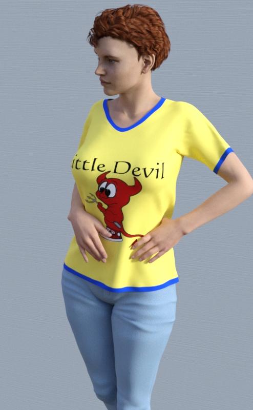

I'm continuing to refine both my workflow and the home-made t-shirt that I'm using to test things. This is a good example of a garment that would fail badly with auto-fit, and a pose that pushes beyond what could be done with traditional DAZ workflow. Note that this same t-shirt will simulate and render without distortion on Michael 6 or Olympia 6 or, presumably, any other exotic variation.
