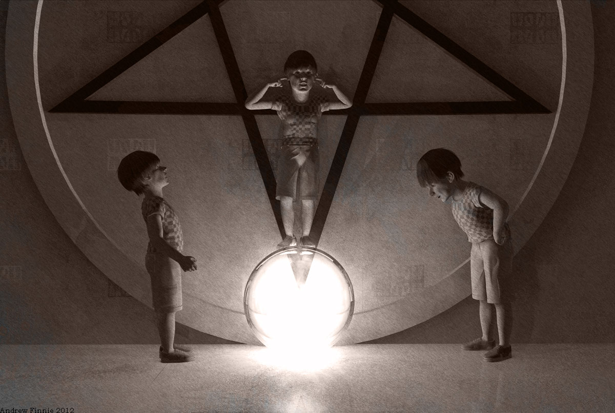

    out of interest this is what I have come up with so far
    this last one shows the detail best
    1200 x 1013 - 220K

    here's a render I used it on, an old B9 model of mine
    have you seen http://www.optikvervelabs.com/ very nice stuff.
    BrianP21361
    thanks :) the artist is very good, I wonder where he gets his models from? He is worth emulating I think. Or learning from at least.
    BC Rice
    thanks for that link. i'm looking more for the pencil look but I downloaded the india ink plugin after that. looks useful! His work is good. :)
    690 x 900 - 166K
