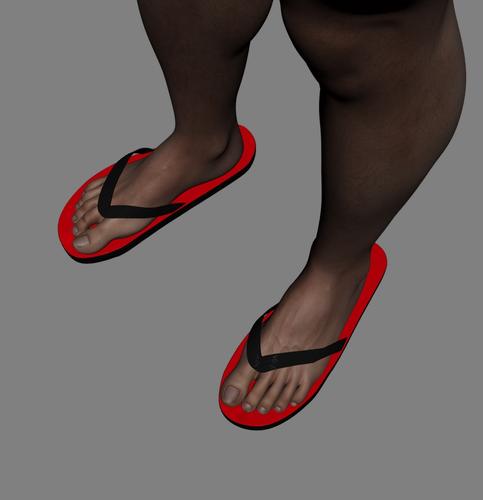

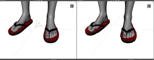

    left: genesis untouched right: only morph applied is m5

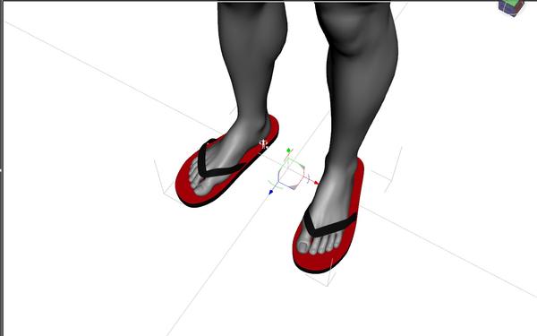

    Did that. it fixes the shoes but they are now huge compared to his feet. Scaling up his feet scales them up too. Scaling down the shoes slides them off and into the stratosphere.

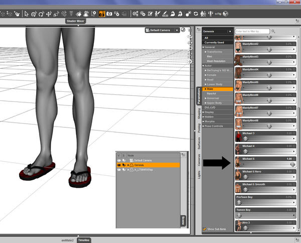

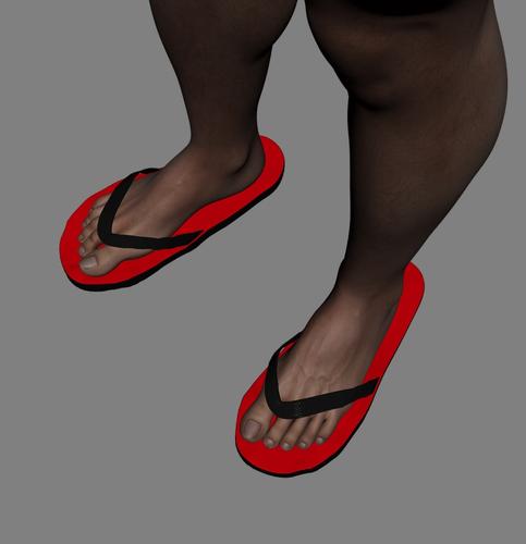

    I was playing around with these Flip Flops on the M5 shape and adjusting the parameter dials. I saved out the modified Flip Flops and they seem to keep their shape when re-applied to the M5 character/shape.
    1. Load Genesis, apply M5 shape or Load Michael 5 character
    2. Load Casual Surf Wear Flip Flops, conformed to Genesis
    3. With A_L75M4FAFlop selected on the Scene tab
    a. Go to Parameters Tab
    b. Show hidden properties:
    c. Change Actor>Male>FBMMichael5 to 10%
    d. Change General>X Scale 90%
    4. On Scene Tab, select A_L75M4FAFlop, Right Click>Expand>Expand from Selection
    a. Select Left Foot and Right foot bones
    5. Go to Parameters Tab
    a. Change Z Scale 90%
    b. Change Y Scale 92%
    c. Change Side-Side to -2
    6. On Scene Tab, Select A_L75M4FAFlop
    7. Go to Parameters Tab
    a. Adjust Actor>Adjustments>ADJ Toe in LT and
    Adjust Actor>Adjustments>ADJ Toe In RT
    Until strap is aligned between toes
    8. Save modified flip flops
    a. File>Save As>Support Asset>Figure/Prop Assets
    b. Select a directory, apply a name, click Save
    c. Save Options, I just leave as is and click Accept
    Notes: Feel free to adjust the parameter dials to your liking. When you load the modified flip flops to M5 shape, it does hold it's shape when posing, but if the pose is extreme the flip flops may deform a bit and may need additional parameter dial tweaking. Make sure you keep the hidden parameter visible otherwise you won't see them.
    Below are Before and After images.

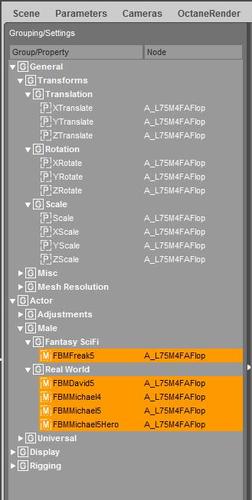

    I would like to do some conversions using the various methods and compare the results, but I noticed when I load a "fresh" unmodified pair of Surf flops and display the hidden morphs, those I added using the Presentation Editor still appear. How would I go about removing them?
    I've attached a picture of what I want removed. I tried the following:
    1. Uninstall and re-install using DIM
    2. Use the Presentation Editor and change the full body morph's Content Type from "None" back to "Modified/Shape/Generated"
    3. Selected the morphs, right click "Remove Properties"
    I don't see anywhere in the Presentation Editor a save button, so I assume it's making some change somewhere... but when I re-load the "fresh" pair of Surf flops alone in the view port those hidden full body morphs I added are still there.
