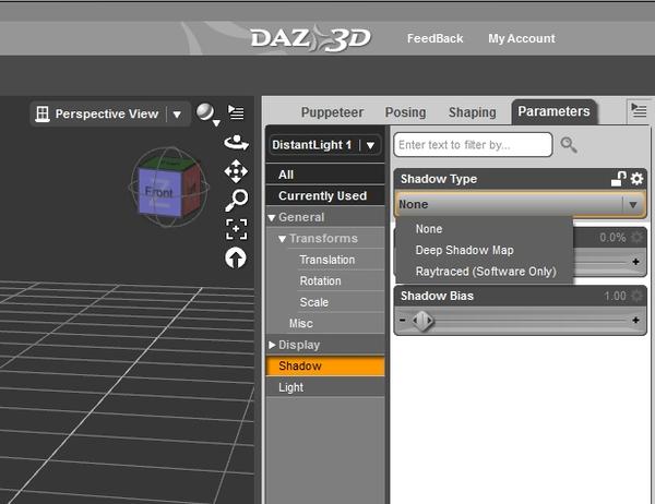

    click on the light in the scene and under the parameters tab there is a section for shadows.

    I assumed he meant ray traced shadows which the OP probably doesn't even have on unless it is from a 3rd party light. I get no shadows when switched to "none" so to me that means no ray traced shadows unless i am missing something.
