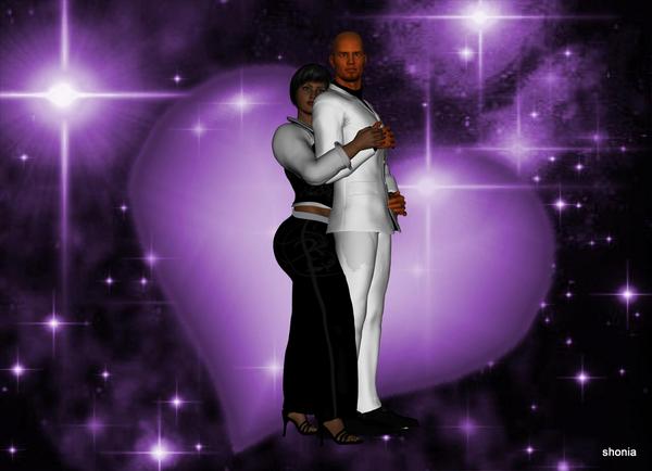

I have been trying to turn my Michael 5 into a light skinned male but it looks red can anyone help me with how I might be able to change Michael 5 light skinned. I have enclosed a real picture of the color I have ad what I would like to get close too.

    Which skin texture did you use in the render?

    I just just the Michael 5 base model and tried to darken him but of course it was a fail. lol any help would be very apppericated for I am doing this for a friend and his girl thank you.

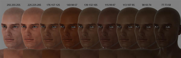

    As ZamuelNow suggested, the diffuse color can be adjusted to make the skin appear darker. You just have to be subtle with the color you add. Also note that the Caucasian skin textures contain a lot of pink, so you want your diffuse colors to lean toward the greener side to keep the skin brown. In the picture I have attached, default Michael 5 is on the left with diffuse set to full white (RGB 255,255,255). The next 2 faces have a redder diffuse set, looking maybe a bit more Hispanic or Native American. The final 6 faces are examples of what you can get toward a more African color. The diffuse RBG values I used are written above each head. Good luck!

  • JaderailJaderail Posts: 0
    Peeks in. See's Slosh's post. Squeee!! Nabs the image for the Fast settings. So love some of these. Thank you Slosh.

  • ShoniahagoodpoliteShoniahagoodpolite Posts: 10
    t
    Thank you so very very much
