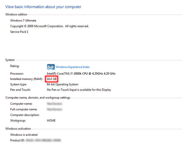

    500Gb...? Sounds like someone is quoting hard drive space, not actual memory. One thing to consider is that Windows does require a significant amount of extra space for its swap files so it's plausible that it could be an issue. However, you've still neglected to tell us how much actual RAM is in your machine. An example of the screen you need to look at is below.
    Go to control panel and click on 'System'. It will show you the amount of RAM installed on your PC. If you right-click the taskbar at the bottom of the screen you can also open the Task Manager which will show you how much RAM you have free.

    K ty for that. My total Installed RAM is 4.0GB the RAM avaliable is 1091.
