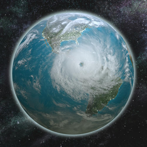

    I ended up editing the prop in my CR2 editor and adding in the materials and then saving it as a copy. I then opened Poser and made a materials file. I then took the materials back into my CR2 editor and started copying and pasting the material info from the PZ2 into my base MC6 file and save it out under a new name. So far it’s working. Just a shame that I have to go to such extremes to get it work.

    Well you could look at it this way,the plus is you now have it working for you in Poser,and you won't have to do it again ......hmmm here's a thought ,to make sure you don't have to do it again,I'd zip up a copy of the Mc6 files along with the original and save it ...just in case ....Glad ya got it worked out ,does make you stop and think though what PA's have to go though trying to keep everybody happy ........
