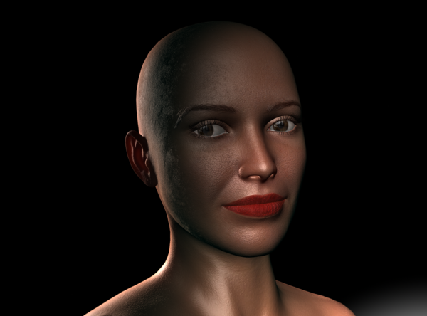

  • AlexBarclayAlexBarclay Posts: 0
    After trying to figure out how to use SSS with Human Surface to add that "extra" level of realism, I finally made some progress.
    Notice the Spotlight behind Victoria illuminating her ear in my attached render. But SSS really adds a great level of depth to the skin overall. I'm happy I finally made some progress in figuring this one out.
    1024 x 758 - 513K
