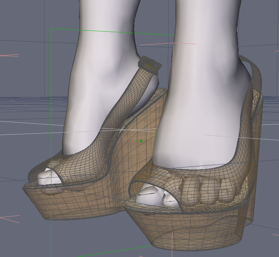

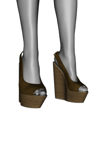

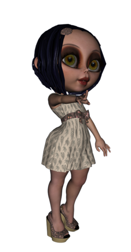

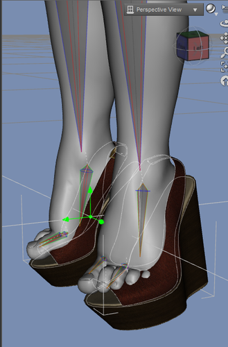

    It works for shoes...I achieve it with my poor abilities in Hexagon for some shoes. I'm stuck just now in custom morphs for genesis extreme shapes like chibigirl, because of morph loader change rigg position of toes.
    First is OOT V4 shoes convert to genesis, success!!. Second is transform it in hexagon for chibigirl. Third is result after morph loader, fail :(. Fourth is a prop morphed version parend to chibigirl, poor solution...meanwhile

    As far as I knew...shoes still weren't a perfect convert with auto-fit...I see what funky things it does to the heels and such. It works better for tight fitting shirts ans such. Of course...I 1st used auto-fit beta...hasn't been able to use daz for like a year, but I know it's been upgraded

    Nope..I don't say autofit works. I say using hexagon to adjust shoes to genesis works :). This is the example in images.
