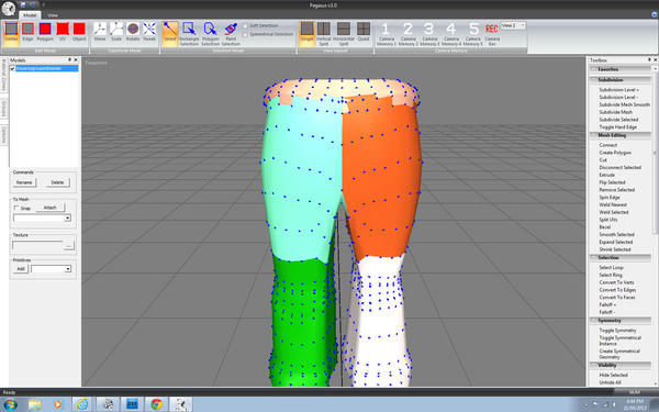

    @ head wax - can't tell for sure, but it looks as if the crotch group doesn't go all the way to the belt at the back? If so, it means that the two legs in the backside area have different parent groups - you don't want abutting groups with different parents, that will cause them to separate. :)
    thanks Roy that's probably it, good call!

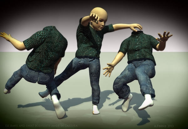

    this is the backside as it comes out of poser without fiddling
    the second image is a K4 bodysuit I pulled out of his mesh -as you do :) I'll post it in the render section but wanted to throw it in here

    head wax said:
    the joints still need tweaking as far as the falloff zones
    and the mesh splits at the groin when K4 does the splits
    hmm, not sure why
    maybe this thread would tell me http://www.daz3d.com/forums/discussion/2174/
    Hi as Roy has said, you have the left thigh group in contact with the right thigh group.
    That's a common problem with autogrouping the K4 rig due to its small size.
    Use the grouping tool in poser to change the central polys to the 'hip' group.
    The easiest way to do this would be front camera in wireframe mode. (wireframe in Poser allows the backfacing polys to be selected in the grouping tool)
    Make sure you weld the hip group after you've done the re-grouping or you'll still get tearing.
    Thanks for that RoguePilot. Appreciated :) !!!!

    thanks Dart,
    just to explain the second image is just K4, I morphed his mesh, didnt add anything with pegasus

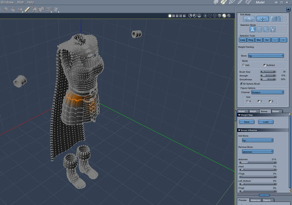

    you know that there is a save thingy for wieght maps in Carrara?
    I don't know if it works.
    interestingly, I found it without trouble this morning and then later, no matter what I did, I couldn't find it again :(
    and still can't find it!!
    to quote manual
    To save a modified weight map:
    1) After your weight map is modified, choose the
    Bones tab in the Model room.
    2) In the Weight Map section, click the Save button.
    The Save Weight Map As dialog appears.
    3) Locate the folder that will store your modified
    weight map.
    4) Assign a name to your file and click Save.
    Weight maps are saved with a .cwm extension.
    hmm I must be doing something wrong ;) not like me :)
    and I managed to crash carrara with one mesh and two bones .....
    hmm found it again, who knows what's going on ?
    1300 x 914 - 159K
    Post edited by Headwax on

    head wax - when you send a cr2 model to the VM, you get an option to save the weight map - no-one has ever explained what the point of that is. You don't get this option with Carrara-rigged models - which is where you actually need to be able to save:)
