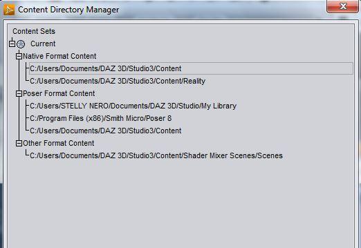

    Well, the old advice you saw probably related to DS4.0 or earlier. But have you tried a new scene, with new content (actually, it would probably be enough for testing purposes to create a couple of primitives from the Create menu), saving that and reloading? If that fails, or is failing after you've tried it already, my guess would be that there's something odd with the DAZ Studio Content directory paths - please post a screen shot of your Content Directory Manager (right-click on Content Library pane's tab to launch it) with Current>DAZ Studio Content Directories expanded.

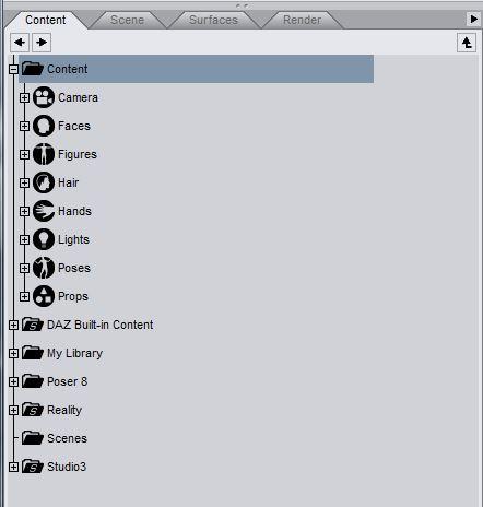

    GRRR Ok I AM convinced it's a directory issue, but no clue why I am convinced of that LOL. I am having a NEW issue that is most likely related where I am trying to save a new scene, and I get "An error occurred while saving the file, see log file for more details." This is saving a new scene with content that ALL worked before, both saving and re-loading later. I am able to load an old saved scene, say from a month ago, with no issues, then without making any changes immediately save the scene and just give it a new name and I get the same error. The issue I WAS having was being able to load a scene but now I can't save either. Crazy. I haven't made any changes to my knowledge. I'm going to start by posting the directory images you requested. Please not that I will be at work all evening into the night so I won't be able to respond again until I get home. This is very frustrating as I don't want to lose the scene I currently have in my viewport :( I don't understand why I can't save now when before it was an issue loading saved files. Sumthin' funny goin' on here LOL! Hopefully the attached directory images can help someone to help me :)

  • JaderailJaderail Posts: 0
    Do you have the Figure installed in the DS3 Content folder or just the DS4 My Library Folder?
    Either way your My Library folder needs added to the Native Formats section not just the Poser Formats.
  • edited December 1969
    Either way the My Library folder is a Daz Studio Native folder with a Runtime in it. It should be listed in both. Not just under Poser Formats.
  • edited April 2013
    Thanks...I did go and add it to that directory while waiting for your reply since I'm kind of desperate LOL. That didn't help I still can't save the scene :( Do you think I should maybe run that "search for content directories option"?

  • Richard HaseltineRichard Haseltine Posts: 111,972
    I suspect the issue is having nested content directories - you have both Content and the Reality folder within Content selected. Try removing the reality folder from the list for now and see if you can then save a new scene.
