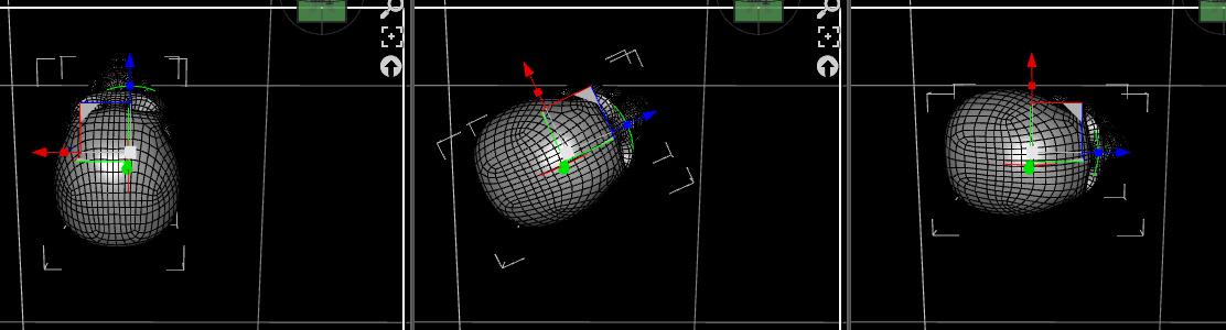

I have the following 2 scripts that find a node (merlins skull) and rotates it 90 degrees. the second uses an overloaded version of DzQuad
var nNode=Scene.findNode('MRLN_MSSkull_7542');nNode.setLocalRot(DzQuat(0,1,0,Math.PI/2);
var nNode=Scene.findNode('MRLN_MSSkull_7542');nNode.setLocalRot(DzQuat( DzVec3(0,1,0),(Math.PI/2)));
As you can see from the attached image, they give different results.
image one is starting position, two is script 1 and three is script 2. (script 2 is how I would expect it to behave.)

  • jag11jag11 Posts: 885
    Movement is contrained by ERC or riggin, disable YRotation(Twist control) limits for that node.

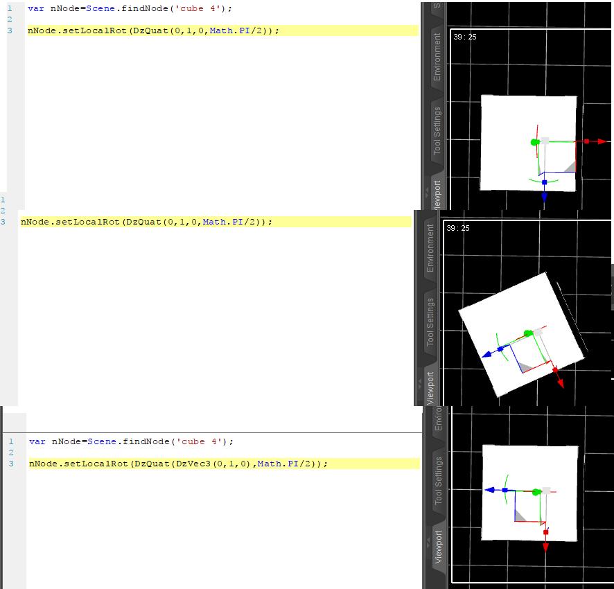

    it seems to be doing it even with a primitive cube- with no limits or rigging.
    886 x 850 - 236K
    Post edited by BradCarsten on
    I tested it and you are right, I think you've found a bug, now you can go reclaim your CS report number. wink
  • Submitted laugh​

    The first constructor you use with four values directly sets the 4 values of the quaterion directly (equivalent to setter "setValue(x,y,z,w)").
    The second constructor is creating a quaterion by converting an axis and angle pair to a quaterion (equivalent to the setter "setValue(DzVec3 axis, double radians)").
    They should almost always yeild a different results from each other, when given the same numbers.
