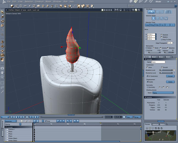

    @3DAGE
    How did you get the flame shape of the candle to stay "flame-shaped"? I keep getting a black x-shapped image where the flame should be. Maybe it's the candle I'm using? I'm pretty sure the texture maps that create the flame image are placed on the x-shape (so it can be seen from all sides), but I can't make the shape vanish after making the flame a Lux Surface.
    3DAGE said:
    Nice example candle GK :) ..and very helpful tips for setting that type of scene up in Luxus.
    No lights in this scene,.. the Candle flame model is an "Area light" material.
  • 3DAGE3DAGE Posts: 3,315
    HI Salem2007 :)
    I made the flame as a vertex model,. (using an extruded circle),. it's a separate poly-mesh, but still part of the main candle model.
    Doing it that way, allows you to create a shading domain, and shader, for that part,. ...make the "flame" shader a "Lux Area Light"
    I'm not sure that using a "Billboard" of crossed planes, with an alpha image applied to them, will work the same way, since an Area light should use the mesh it's applied to,. Like "Anything glows" lights in Carrara.
    pic
    1280 x 1024 - 240K
  • Salem2007Salem2007 Posts: 513
    Ahh--thanks for that 3DAGE. I tend to avoid the modeler room, but now I see why I get the black box shape. I took the "billboard" polys and changed them to 1% size so I get just a small glint of light and the effect of light from the candle. It'll work for what I'm trying to do.
    As a side note, I initially tried to set the "billboard" ploys to 0% to see how they looked---either LuxRender or teh Luxus plugin was not happy. I was never able to get the scene to render ecasue LuxRender kept crashing. Just changing the polys to 1% fixed it. I don't think it's a bug, but it's interesting in a way.
    Here's the candle after just a few cycles...
    1024 x 486 - 53K

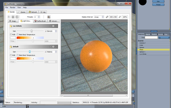

  • edited May 2013
    Nice, it's good to see the updates coming so frequently ;-)

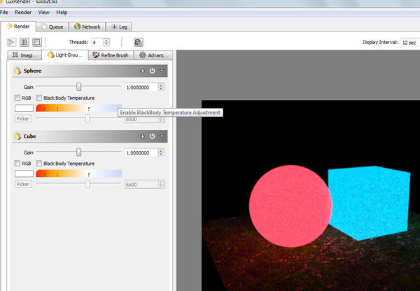

    I have a question now...

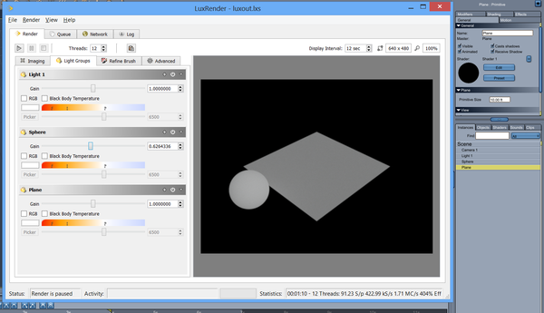

    How do I set up individual "lightgroups?"

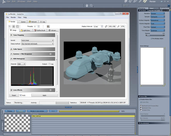

    I'm using multiple Luxrender area light materials and I'd like to be able to control their tonemapping independently, but all area lights seem to automatically come together as a single group as of now...
    Is this ability even implemented at this point?
    Post edited by K0daKumi_8e8836aac0 on

  • SphericLabsSphericLabs Posts: 598
    edited May 2013
    Koukotsu said:
    It doesn't help, as far as I can tell there just isn't a way to create light-groups in Carrara at the moment.
    I'll keep experimenting though, lol ;-)
    Right now the light group is the name of the node. Are you wanting to do different area ligths on the same node but different shading domains?
    1501 x 863 - 172K
    Post edited by SphericLabs on
  • edited May 2013
    Hmm, I'm not sure why but my light emitting shaders/area-lights are all merging into one single group labelled "default..."
    I have a sphere using a lux-area light material and a plane using it's own lux-area light material and Luxrender wants to treat them as if they were a single light for some reason.
    If possible I would love to be able to assign different light groups on a per-shader basis.
    I'm using Windows 7 64-bit and the latest Carrara Beta (I think? :red:)
    Yeah, Carrara 8.5 Pro build 204 with the latest version of Luxrender standalone as well.
    1236 x 778 - 624K
    Can you screenshot your light emitting shader settings?

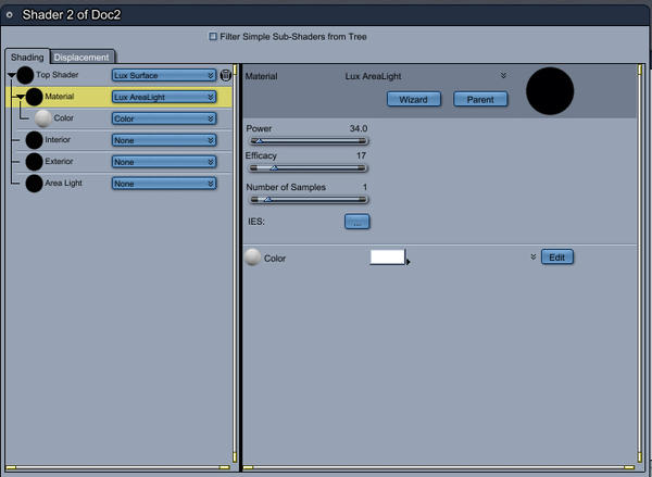

  • edited May 2013
    Sure, here it is, it is quite possible that I'm goofing up somehow on my end.
    I'm just using a simple primitive plane.
    Adding another primitive/vertex object/etc., and using a light emitting material doesn't create a new light group, instead they all get grouped under the "default" label.
    The shaders aren't consolidated either, they are both individual/different materials.
    723 x 529 - 119K

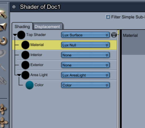

    Area Light goes in the Area Light slot.(the last one). The one below Exteiror. :)
    edited May 2013
    Hi Koukotsu :)
    try this shader setting on each of your objects, they should then show up as individual lightgroups.
    You can also set the main material to NONE, instead of the "Lux Null"
    then set the Area light option at the bottom of the shader,. with your colour or whatever. :)
    954 x 662 - 110K
    506 x 445 - 40K
    Post edited by 3DAGE on
    3DRage said it better.
  • edited December 1969
    3DAGE said:
    Hi Koukotsu :)
    Oh yeah, that did it, thank you so much! :coolgrin:
    I would have never figured that out on my own, lol. :red:

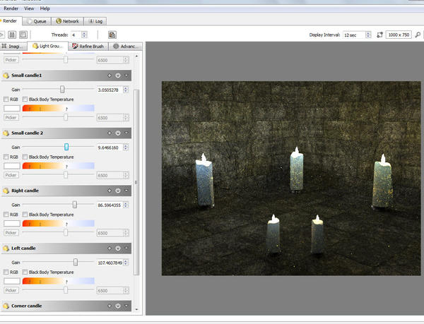

    edited May 2013
    Thanks Spheric :) and Koukotsu,.
    good to see you and mulberry :)
    It's also important to name objects,. if you have multiple (duplicates) of an object,.
    So that each object can be assigned to a different light group.
    You can set different Area light shaders up,. but if you apply them to duplicates which are named the same EG: "Vertex Object"
    then they'll all appear as one Lightgroup called (Vertex Object),. even if they have different area light shaders applied to each duplicate.
    give each duplicate a different name in the instance list, and you'll get a lightgroup for each.
    1096 x 838 - 224K
