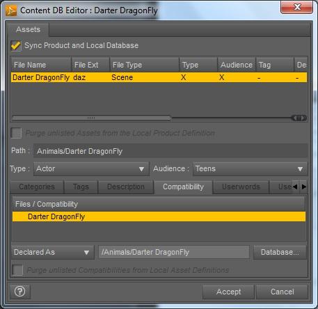

    I tryed it with the Darter DragonFly (old Content), made the Darter DragonFly to an Actor, made a compatibility base "Animals/Darter DragonFly", set the Darter DragonFly (Actor) to the compatibility base, load the Figure to the Scene, did the Scene Identification to the Darter, go to the Materials of the Darter, in DB Editor i choosed "Presets/Materials" for Type, set "Root Category" to "Default/Materials/Skin", set Compatibility Base to the Animals/Darter DragonFly.
    I Reload the Smart Content Tab, the Darter DragonFly is there as Actor, but if i load it to the Scene nothing else Show up there. No Materials ... nothing ... only the Datrer DragonFly as Actor .... !???

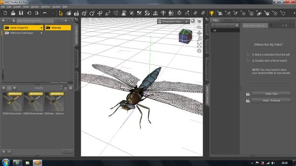

    Sounds like you have everything setup properly. This is what you should see:
    1. Load the Darter Dragonfly into the scene.
    2. With the Darter Dragonfly selected, click on the Smart Content Tab, Files
    Click on the Presets group and you should see the materials that you associated with the Darter Dragonfly.
    Double click on a preset to apply the texture.

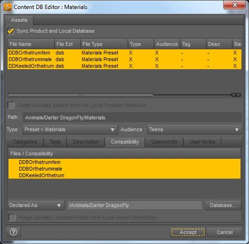

    If I read that right then you declared the material as Animals/Darter Dragonfly instead of making it compatible with it. The 'Declared As' segment tells Daz what that object is meant to be, but if you right click the dragonfly in the list and add the Animals/Darter Dragonfly there it tells Daz what it's compatible with.
    Once that's done, and the Dragonfly is identified, your materials should show up fine. Be sure to deselect the dragonfly and reselect to repopulate the Smart Content tab.

    No i declared the Materials as "preset/materials/skin".
    I set the compatibility to the "Animals/Darter DragonFly", as written in the tutorial.

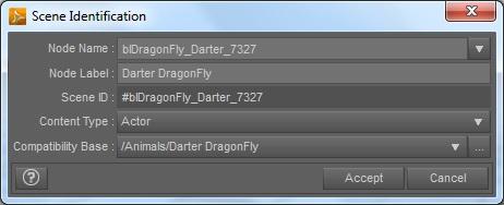

    Could you post screenshots of the following:
    - The compatibilities window showing the Dragonfly model, expanded as necessary and including the declaration at the bottom.
    - The compatibilities window showing the Dragonfly materials, expanded as necessary and including the declaration at the bottom.
    - A shot of the Scene Identification window for the Dragonfly
    This will pinpoint exactly what the issue is with the metadata so we can help further. It can be a tricky thing to get nailed down without all of the information.

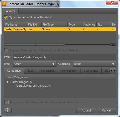

  • yandrisyandris Posts: 93
    Ok,
    here are the Screenshots of the configuration i have made and my Problem that nothing appears in the Smart Content Tab after loading the DarterFly.
    Hope you will find the error that i made ;-).
    Thanks a lot!
    Stop !!!
    I don#t beleave it, i found my mistake ;-) !
    HeraldOfFire you were right !!!
    I declared the Materials like the Darter DragonFly as "Animals/Darter DragonFly".
    Now i changed this to Not Declared and rightclick to the Textures and set the Compatibility to the Darter DragonFly.
    And... what should i say ... BINGO ! That was it !
    Muchos Gratias to both of you! You saved my life ... ahmm ... the life of the Content library on my PC ;-) !!
    Thanks !
