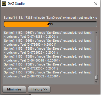

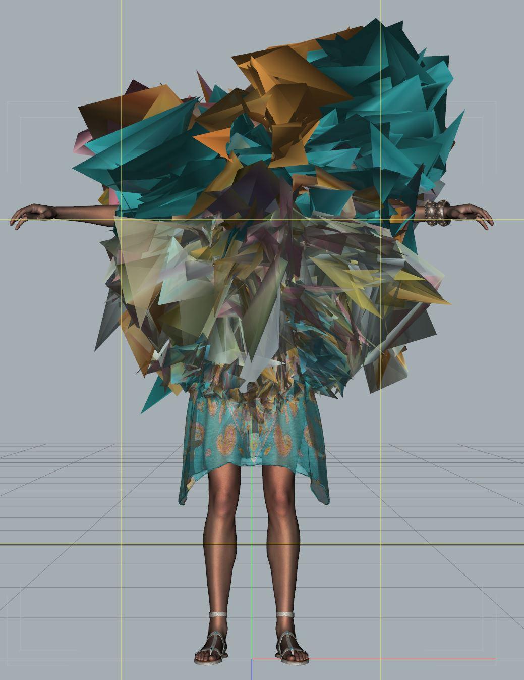

    4.10.0.118 feedback:
    I fit the Summer Sundress to Victoria 5 Supermodel. I applied dForce Dynamic Surface and simulated with default settings. I got a dialog box with hundreds of message scrolling by about collision offset. (Yes, I read about changes in the first post in this thread; it implied to me that it should help prevent explosions, but it did not.) There is no way to cancel this operation. There is no cancel button and the X in the corner did not close it. I just had to wait for it to finally finish.
    There are correspondingly hundreds of messages in the log file like this:
    2017-11-18 19:10:38.262 Spring(25376, 25377) of node "SumDress" extended: rest length < collsion offset (0.048295 < 0.20001)
    2017-11-18 19:10:38.263 Spring(25378, 25379) of node "SumDress" extended: rest length < collsion offset (0.0350581 < 0.20001)
    2017-11-18 19:10:38.264 Spring(25380, 25381) of node "SumDress" extended: rest length < collsion offset (0.0360791 < 0.20001)
    2017-11-18 19:10:38.265 Spring(25382, 25383) of node "SumDress" extended: rest length < collsion offset (0.0381764 < 0.20001)
    2017-11-18 19:10:38.267 Spring(25384, 25385) of node "SumDress" extended: rest length < collsion offset (0.0350709 < 0.20001)
    2017-11-18 19:10:38.268 Spring(25386, 25387) of node "SumDress" extended: rest length < collsion offset (0.0302122 < 0.20001)
    2017-11-18 19:10:38.269 Spring(25386, 25393) of node "SumDress" extended: rest length < collsion offset (0.187536 < 0.20001)
    2017-11-18 19:10:38.270 Spring(25387, 25392) of node "SumDress" extended: rest length < collsion offset (0.187691 < 0.20001)
    2017-11-18 19:10:38.271 Spring(25388, 25389) of node "SumDress" extended: rest length < collsion offset (0.0283884 < 0.20001)
    2017-11-18 19:10:38.272 Spring(25390, 25391) of node "SumDress" extended: rest length < collsion offset (0.0375987 < 0.20001)
    2017-11-18 19:10:38.273 Spring(25392, 25393) of node "SumDress" extended: rest length < collsion offset (0.0350159 < 0.20001)
    2017-11-18 19:10:38.275 Spring(25394, 25395) of node "SumDress" extended: rest length < collsion offset (0.0748992 < 0.20001)
    2017-11-18 19:10:38.276 Spring(25396, 25397) of node "SumDress" extended: rest length < collsion offset (0.0712059 < 0.20001)
    2017-11-18 19:10:38.277 Spring(25398, 25399) of node "SumDress" extended: rest length < collsion offset (0.0496475 < 0.20001)
    2017-11-18 19:10:38.278 Spring(25400, 25401) of node "SumDress" extended: rest length < collsion offset (0.0538031 < 0.20001)
    2017-11-18 19:10:38.279 Spring(25402, 25403) of node "SumDress" extended: rest length < collsion offset (0.0500406 < 0.20001)
    2017-11-18 19:10:38.280 Spring(25404, 25405) of node "SumDress" extended: rest length < collsion offset (0.0475225 < 0.20001)
    2017-11-18 19:10:38.282 Spring(25406, 25407) of node "SumDress" extended: rest length < collsion offset (0.065294 < 0.20001)
    2017-11-18 19:10:38.284 Spring(25408, 25409) of node "SumDress" extended: rest length < collsion offset (0.0601416 < 0.20001)
    2017-11-18 19:10:38.285 Shortest spring had length: 0.00235879
    After this finished, the simulation started and exploded very quickly anyway.
    By the way, collision is misspelled in the log messages.
    356 x 335 - 13K
    1039 x 1347 - 146K
    Post edited by barbult on
    By turning off Self Collide and creating a weight map, I was able to stop the explosion on Summer Sundress, but it is very annoying to sit and wait for all the error collision offset error messages to scroll by in the interface every time I want to make an adjustment and simulate again. Can that be streamlined?
