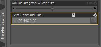

Before you start your next Luxus render, Type into the “Extra Command Line” box “-u ###.###.###.###” if you have five computers in your house you can add all Five of them to your you just put a Space and then another “-u ###.###.###.###” for every computer you have LuxRender Slave running on.
Even if you are using the UI it will setup the Nodes under Networking and still send part of the rendering to the Slave.

NOTE: I updated this with an image show you how to input of Multiple LuxRender Slaves.

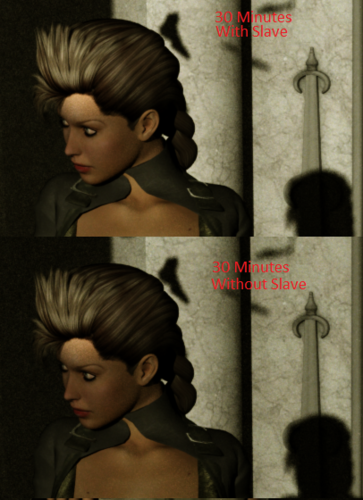

    I am just finishing up some tests, but I'm thinking I need a more complex scene.
    I just have three Systems, 2 windows Slaves and one Mac slave a total of 10 CPU cores, all running 1.2.1 of LuxRender.
    NOTE: the Main system and the Slaves must be on the same version of the program
    Also the IP of the Slave machine is presented at the time you start the slave process, so you don't have to go digging through the command line.
    See attached Image.
    I have also attached an image of two renders both 30 minutes long

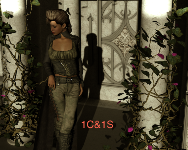

    Rendering with Luxus & LuxRender using Slave computers Part 1:
    So I wanted to get you some stats so that you could see the benefits of stealing Processor time from anyone you can.
    The Hardware and Software Setup.
    I have four systems A MacMini 2010 version. Added to this are Three Windows 7 64bit systems, each has a P5G41-M LX system board with 8GB of DDR3 Memory. These three system as three differed Processors a Q8300, E8400 and E6750. The Q8300 is my DAZ Studio system and the other two are my MMORPG Boxes. These system boards are capable of 1Gb Network speeds, so my network had 1Gb Switches and cables are Cat6.
    HeraldOfFire is right about the GPU rendering with LuxRender and but it is coming in version 1.3 according to their site. Because of this No GPU were used and this is CPU rendering.
    LuxRender 1.2.1 64bit running all all system. I set the UI to stop after one hour of rendering, (I didn’t want this to take all week). I used Linear Tone map with Film set to 200, Shutter to one second, f-stop at 5.6. I had fun with the Film Response and set it to Kodak Gold 200, which gave the Render those warm tones. I also set the Color space to D65 Daylight.
    I think that covers the hardware and software settings, now onto the show!
    The Renders

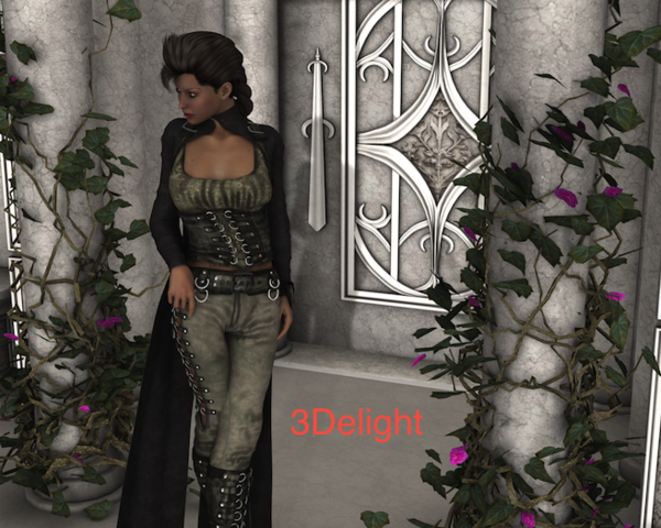

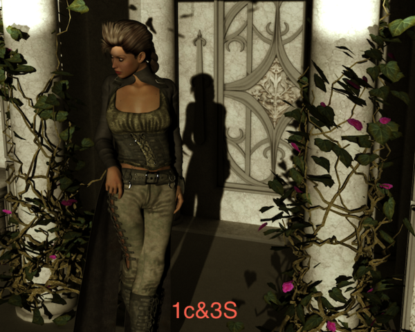

    I had a scene threw together for another test so I pull it out. The set it The Alcove I think I just dropped in the pre-made set which came with lights. The Lady is Victoria 4.2, the Domino coat over Edens Flame Outfit, with Venom hair. Like I said I threw this together. And the render window is 1312x1049.
    So I rendered my test image in 3Delight, on my MacMini, just as a Reference. (The images have been reduced by 50% for the Forum) That image is marked 3Delight.
    So the first test I ran was the Single machine no Slaves and the images is marked Single. The second I added one Slave to the once Console for a total of 6 CPU Cores and image is marked 1C&1S;. The third test was The Console and 3 Slaves for a total of 10 CPU Cores and it is marked 1c&3S;.
    End of part 1

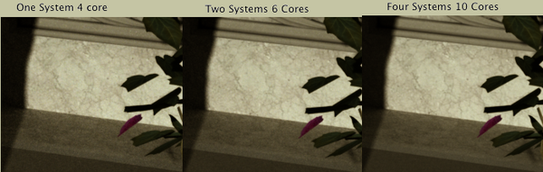

    Rendering with Luxus & LuxRender using Slave computers Part 2:
    As you can see there doesn’t appear to be much of a difference, until you look at the back at the short step. I pulled these out a full Resolution and you can see the refinement that happened due to having more cores working on the render over a Set amount of time, in our case 1 Hr.
    So there is one more image which will help you see the effect the slaves have on the Rendering. This one shows the Render time and various Stats. Notice that the Console (the system running the LuxRender UI) stays pretty much the same at 132.22 in the purple box. But notice over on the right the readings, in the Red box, those are what the Slaves systems are adding to the to the Rendering party.
    Setup was relatively painless and all the computers don’t have to be the same or even running the same Operating System or even have a 3D Video card. The only requirement is they have to all be running the same version of LuxRender.
    The network traffic is not constant between the Console and the Slaves. The Slaves and Console see their information in Bursts so other network traffic isn’t affected much. While doing this I was working on three other computers doing a task that is network intensive and it had very little if any effect on that traffic.
