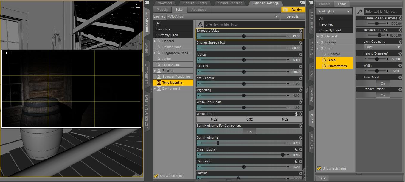

iRay Not rendering lights
So... I'm having problems with lights. And if there is a tutorial that doesn't invovle video (Because I work a lot at night with sleeping people all around me), just point me at it :D When using iRay, no lights work.  I get the ambient occlusion, and I can SEE that there are some lights working... ish... but (As you can see in the attached render), the lights are very weak... even when they are set for 200% intensity.  In the set below I have an orange-yello distant light (set for 200%) coming in the window (light sunlight) and a green spotlight (Just to see if I could see it) also set for 200% shining in the window... I can kinda see the light of the distant light... but I can't see the spotlight at all.  in the scene mode, the entire model is BATHED in orange and green light from the two lights  There should be no white light in this scene at all.  The spotlight is only about 10 feet outside the window.   I've been having this problem since I started using iRay renders so I figure I have a setting wrong somewhere. I just changed video cards and just now have the horsepower to actually USE iRay, so this is all new territory for me (I use to use 3Delight all the time), and I LOVE the renders, they are incredible!  This ambient occlusion is GORGEOUS... but it looks like mid-day... not like sunrise... so can you help me?  Thanks! :D
989 x 881 - 1M
  • FishtalesFishtales Posts: 6,236
    3Delight and Iray lights work differently. In Iray you don't use the intensity slider to get more light you use the luminosity setting. Ambient Occlusion isn't used in Iray what you are seeing is the light from the Environmental Dome which has settings for using an HDRI as a background and or a light source. It can also be set to Draw OFF and sun and sky only .
  • Alright, I see the "Luminous Flux (Lumen)" and it's set to 1500.  AHA! I get it now... Sunlight would be near 32,000 lux at dawn (If I remember my photography classes) ... This explains SO much!  And now the Temperature makes sense as well.  Crank that down to about 2000 Kelvin and we have that nice, red, dawn glow.   Okay, running the render and I have sunlight! Thank you, sir!
    If you are used to photography then go to the Tone Mapping tab and you will find the camera type settings for the scene.
