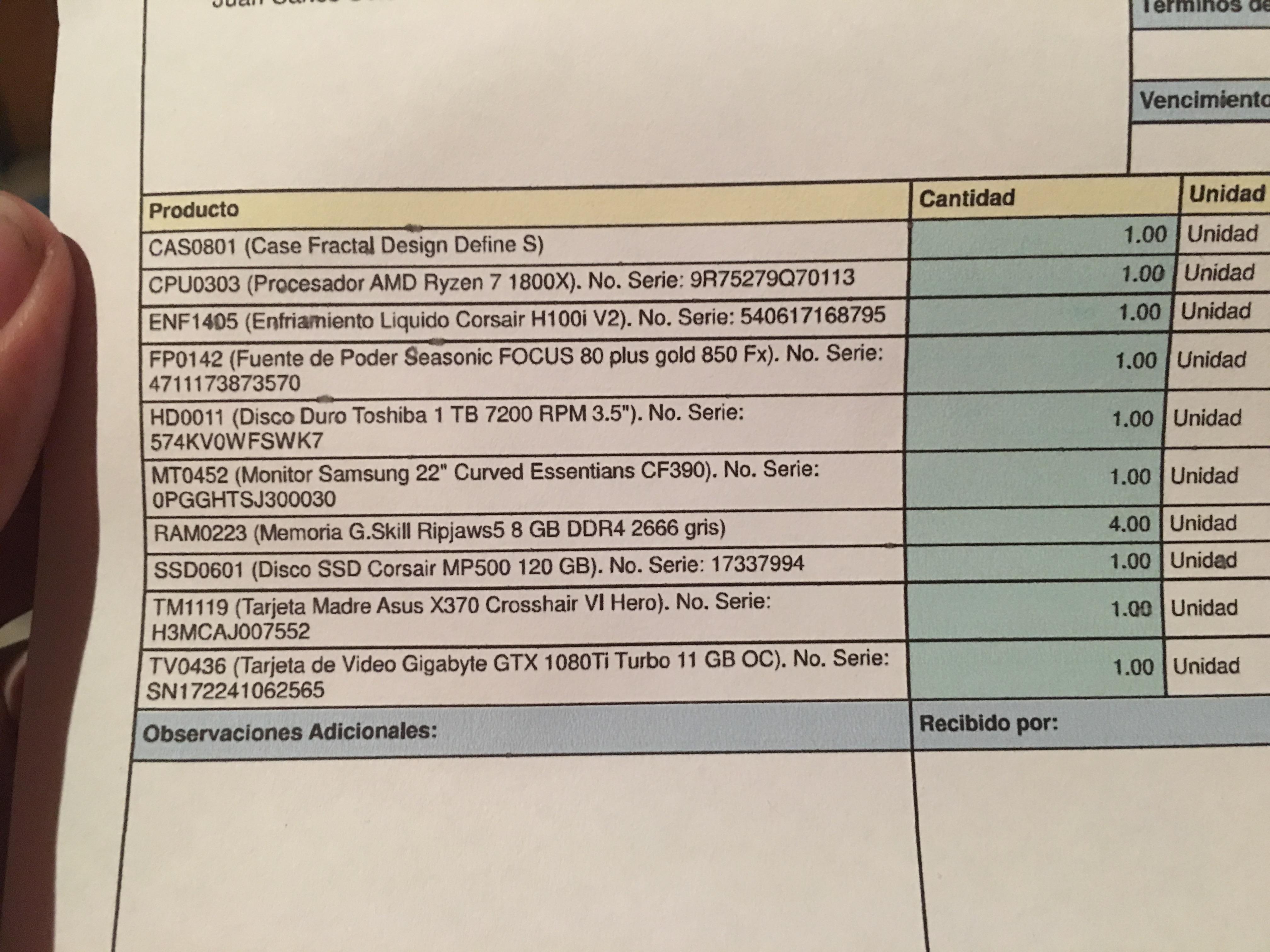

  • SotoSoto Posts: 1,451
    edited October 2017
    Thank you all for your suggestions! You were all a lot of help. I took everything in considerarion and finally went with this combination.
    They are asseambling it. I hope it all goes fine. :)

  • Awesome!
  • kyoto kidkyoto kid Posts: 42,401
    ...excellent.
  • GreymomGreymom Posts: 1,147
    Nice!
