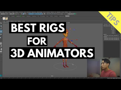

In traditional 3d modeling and animation packages, such as 3D Studio Max and Maya, character animation rigs have a (somewhat) usual set of animation controls. One of these controls is located at the hip and uses inverse kinematics to make the character squat by manipulating only that control.
In this video, the presenter uses this control. He's talking about unrelated stuff, but you can see the control in action. He does it really quickly, so it's easy to miss. You can see the bend at the lengs and hit whole move moving down:
It's at 4 minutes, 27 seconds into the video.
