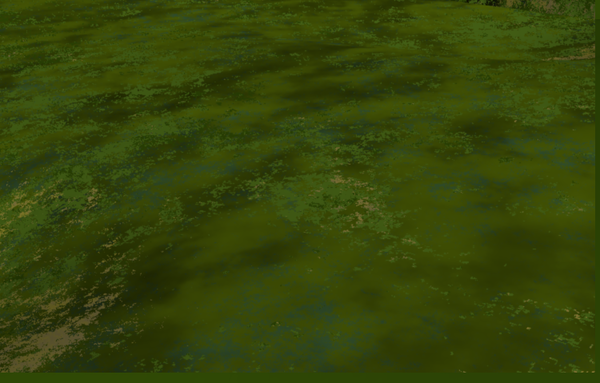

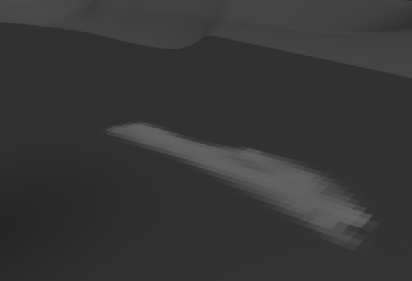

    Okay, back on topic, I'm not grasping how to get one texture to paint on top of another texture. I can load a texture into the color channel for instance and the whole terrain takes on that texture, I can then select a simple color on the brush- White for instance, and I can paint white onto the texture. What I would like is to have a grass like terrain texture and paint patches of a dirt texture.
    I can use RoguePilot's method to create a new texture and have the base color a neutral gray and paint on it, but how do I get my other shader data into it? Do I have to edit externally in Photoshop or something?
    The first image shows the terrain shader I would like. The second is the shader converted to a texture map- Jaggies and all- But, I can now paint it!
    The third image is the terrain a neutral gray and painted on in white.
    Thanks for the help so far guys! I'm not trying to be thick, really I'm not!

  • RoguePilotRoguePilot Posts: 239
    Hi,
    While you're painting don't have the terrain shader applied. That's why you save it to the browser.
    When you have your maps sorted then re-apply the terrain shader but use the painted maps either as part of a multi layer set-up or use them as blenders and multipliers in each component of the terrain shader layers. That way you'll get the effect of your painting while still having the flexibility of a terrain shader.
    To re-iterate. Get rid of the terrain shader. Load up a flat map. Paint. (You can build up in layers if you choose to use a PSD file).
    Now use that map in your original shader to apply your effects.
    For your mud effects the most effective way would be to build a mud shader and then apply that as a layer over your terrain shader using your painted greyscale map as the blender. It doesn't even have to be a procedural mud shader, a tiled image should work just as well.

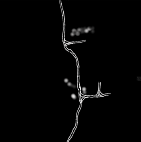

    Cross posting,
    Use white on black instead. When used in a mixer channel black lets one channel through and white the other channel, the blending happens in the grey areas.

    Thanks to everybody for their help! RoguePilot, your suggestion worked wonderfully. I'm doing a test render now to see what refinements I need to do, but so far it looks good.

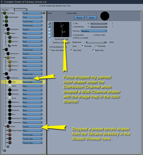

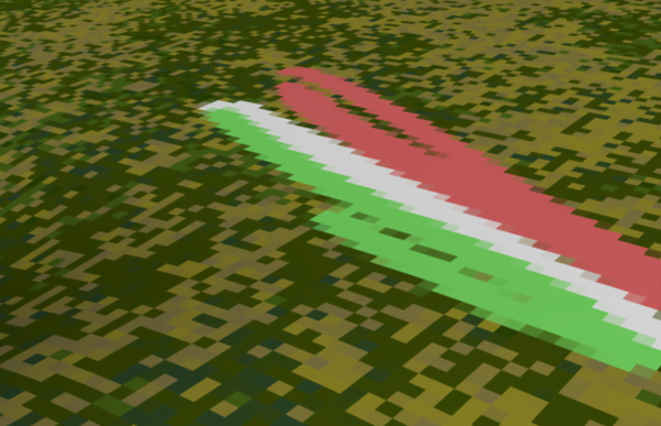

    I'll do what I can. The method was described by RoguePilot but I can show the shader tree and explain the steps I used to get there. I'll have to open the scene so it may be a little bit as I'm working on other elements for the scene at the moment.

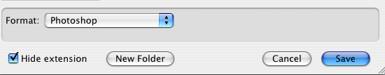

    Following RoguePilot's advice, I chose to create a new color texture. Carrara gave me the dire warnings about the current shader instance being lost, etc. I clicked okay to get through those dialogues, since I used the Complex Green terrain shader from the Carrara native content. I Chose the image map size that would be created and chose Photoshop for the format. I then painted my terrain and left the houses where they were so I would have a reference for the wheel tracks. The brush size will depend on the terrain so I won't go into that.
    After the terrain was painted, I reloaded the original terrain shader from the browser. Looking at the shader and all it's terrain layers etc. I clicked the little plus sign at bottom of the list which gave me the option to create a new Terrain Layer node. I clicked the Shader tab next to the Instances and found the thumbnail representing the painted terrain shader and force- dropped it in the new terrain node's Distribution channel which created a multi-channel shader within the terrain layer. Under the new Terrain Layer's Shader channel which was currently empty I decided to drop in another preset terrain shader and chose Rocks. The result is what you see.
    It's possible I was just lucky, so your mileage may vary!

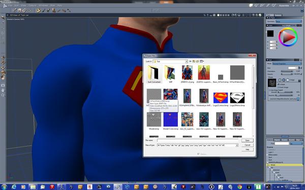

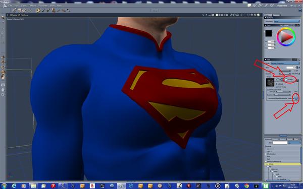

    edited April 2013
    Roygee said:
    Also works pretty well using a preset brush - question 1- anyone know how to set a texture as a brush?
    Setting up a post, hang on.

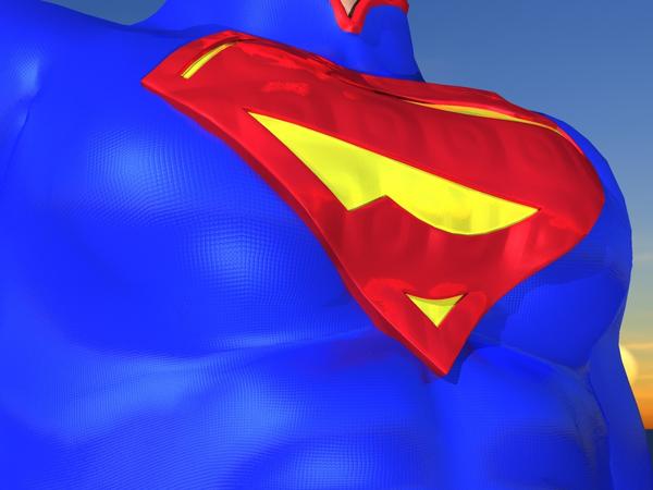

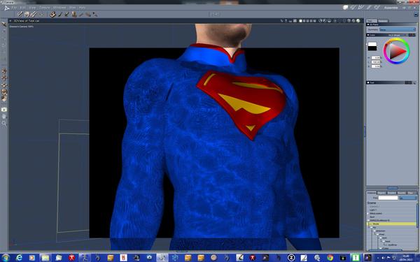

    The suit isn't important here, I just happened to be working on it when I read your question.

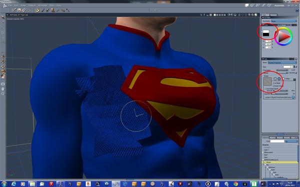

    To set an image brush click on the little patchwork icon, then click on the {...} button to bring up the file selector.
    You can select any image as the brush. In this case I'll be painting on the bump channel so I'll choose my high-tech texture chip.
    You can set the brush to use fall-off or not. You can also set the degree of fall-off as well as the repeat frequency for the image.
    Just a point to note, the brush is effected by the settings in the colour chip. In the case of the bump channel, which would always be greyscale, the white colour puts the brush at maximum intensity with the brush colour modulating the output. Essentially the brush always works as a mask on the bump channel.
    Personally I wouldn't use the texture brush for a perfectly regular pattern, it's too variable, but for a more organic feel it is very useful and it works brilliantly for those blast marks in any space battle. Loading an image into the stamp tool is also useful for putting a logo onto a complicated UV map with morphs applied. (see my New52Supergirl renders).

    So I'm assuming you put blue in the color channel and are restricting your painting by shading domains?
    edited April 2013
    I'm restricting by both shading domains (avoiding the El symbol which is it's own set of domains) and by channel. When you set up a new texture in the paint room you get the option of which shading domains it will be applied to. You also have the option of which shader channels you are painting on (or viewing). There is a restriction on which channels you can view in combination but you could paint on all of them at once or any combination of them.
    Just so you know, the final image is not the result of the rough painting shown in the previous screenshots. That's a much more careful set of applications with a stamp and a larger image brush which has been layered in paintshop. For me the paint room is the start point to build up solid reference images and then the end point to make corrections and add a bit of detailing work. I couldn't produce the textures that I do without it but in order to produce the quality that I want for myself (and for distribution) I still need paintshop to do the heavy lifting. (I work with masks and vectors to produce the maps that I'm known for but they all start in Carrara)
