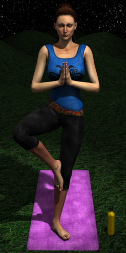

This is an example of several of the techniques I talked about; I used a tight spotlight with a very slight blue tint, with a dimmer more strongly blue tinted light coming from the opposite direction. I also used an uberenvironment light for my diffuse lighting, but turned way down so the brighter spotlight makes my foreground figure stand out.
