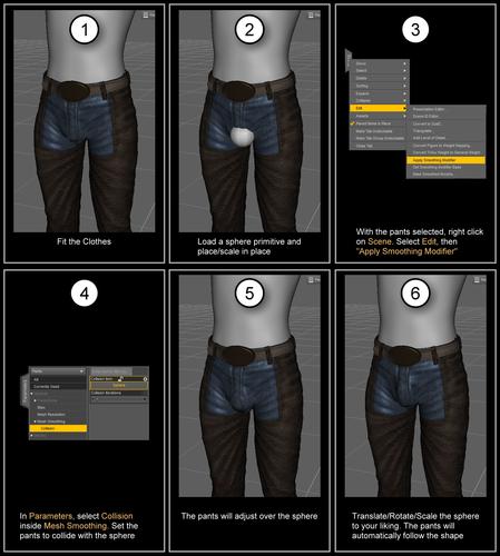

    Just put a ball in there and collide the pants to it.

    1431 x 1594 - 470K
