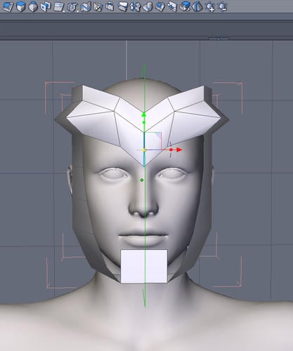

    This is just to show how it could be done and is very rough as I've only spent 10mins on it.
    I started with a cylinder. Positioned it and increased the scale on the x and z axis so it fit the head.
    Removed some of the polys and started shifting things to add some detail.
    756 x 906 - 214K
    Okay this seems interesting, I'll give that a shot. I'm fairly new to Hexagon and this will help. I'll post progress as I do it.

    Cool...I had a thought about the white sections and I'll have a try later this morning and post it if it works. Unfortunately didn't save what I did initially.
