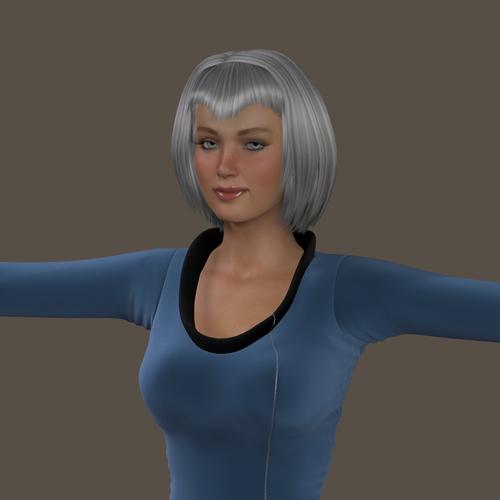

    I've checked out the ShapeShifter thread here on DAZ, and went to PhilC's site, but haven't located the script, yet. In the meantime, I did pretty much exactly as pwiecek described: after a couple of abortive attempts at exporting Laura's head as a morph and getting some really unusable results (the difference in their heights means Laura's head ends up in Aiko's chest, even with exporting it as a morph target only), I loaded Laura along with Aiko and lined up their heads in the scene as closely as possible, then exported Laura's head as a regular OBJ, and loaded that as a morph target. Since I wanted to use Aiko's realistic body, and I don't see any "realistic" morph control for Aiko's head alone, I set Aiko to realistic, then exported her head as a morph target. I also had to unhide the translation controls for Aiko's head, so I could adjust its location once the Laura morph was loaded, as there was some offset in both the Y- and Z-axes. I loaded the 'Aiko realistic' head morph, and after dialing the overall 'realistic' to 1.0, I dialed her head back to -1.0, and set the Laura head morph to 1.0. It looks pretty good, although Aiko's neck is still much too slender for Laura's head; I had to use a lot of magnetic manipulation to get it closer - it's still not perfect, but with hair, it's fairly unnoticeable.

  • Male-M3diaMale-M3dia Posts: 3,584
    Ptrope said:
    I'm not really sure what the relevance of using David 3 would be, since the goal is to create a more realistic head for Aiko.
    The relevance is what you can convert from. For some reason people think the Laura 3 is derived from V3 or another female Gen3 character; what it is is derived from has bearing on what morphs can easily be done from it. So, A3 won't take L3 morphs because how it is grouped and derived. Even with the script, you should be prepared to do some mesh repair.
  • PtropePtrope Posts: 696
    Ahhhh, okay.
    However, I've already used a couple of Laura morph sets on the 'Laiko' head and haven't seen any more problems than I would have expected, given that underneath, Aiko is is lurking ;). These were character morphs, though - I haven't tried loading Laura's standard features or expression controls.
    Thanks for the info!
