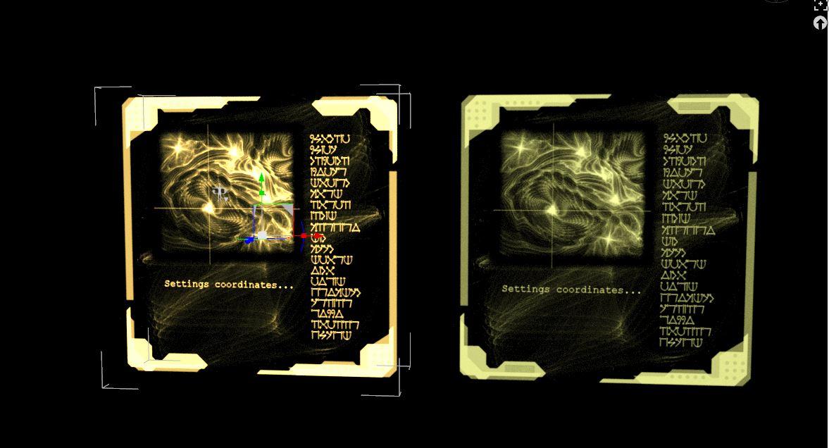

    Hero FX works fine. You'll have to convert then to Iray and put the image into the emission colour slot, and then add the colors from the Diffuse color to Base color, and the colour from Ambient Color to Emission colour. I found that lumiance of 700 k/cm gives a good light.
    Left is converted to Iray, right is out of the box.
    You just me something very usefull thank you.
  • tkdroberttkdrobert Posts: 3,637
    I tried this last night, using the method mentioned by @BeeMKay.  Worked like a charm.
