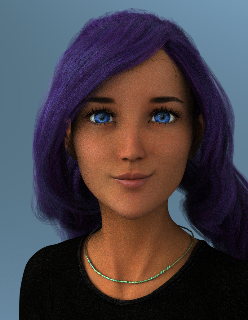

    I've had this occassionally and the OOT hairs were the worst. Sometimes a couple of RedzStudio's hairs. Fixable in post work, but I would prefer not having to do it. While trying to find a fix, I changed the smoothing from Base Shape to Generic and it fixed my black line issues. Haven't had a problem since. Some of the newer hairs don't having a smoothing modifer and I still noticed the black jagged lines so what I did was apply a smoothing modifier and set the Smoothing Type to Generic, Smoothing Iterations to 1 and the Collision Iterations to 2. It all worked for me and I haven't noticed a problem since.
    Thank you for the advice, Glen! Will use that when next I encounter the problem. Hopefully it'll work for me as well!

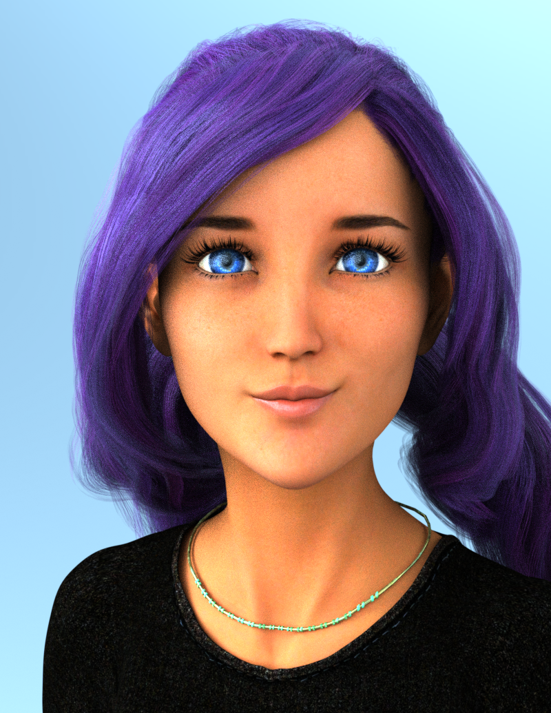

    Ok, I had a recent problem with Sloane Hair where black lines showed when trying to apply it to a G8 figure.
    As it happens, when I checked the smoothing modifier I realized it didn't have one! The solution was simply to add it! I'm going to start keeping an eye out for this. It's just strange because many of the hairs I had problems with, I didn't use to have said problems before!
    But at the very least I'm happy that you've helped me find a solution! As much as I like doing post-work, some hairs were impossible. Like the OOT's corn braids (don't remember the name). I had a render using them and ended up changing the hair because it would require too much post-work to fix the showing skull cap.

    That's awesome! One thing I want to add, some hairs don't do so well with a smoothing modifier. I don't usually have issues, but when I do I dial the smoothing iterations down to 1 and collision iterations down to 2. I'm really glad that fixed your problem. I know how frustrating the issue can be.
  • FenixPhoenixFenixPhoenix Posts: 3,259
    Yeah, I do believe the "corn braids" hair I tried to use before (I think it was OOT's, but I might've purchased it @ rendo) looked worse with the smoothing modifier (because in my desperation I tried to use that). Using the integrated morphs to pull the skull cap back also messed with how the braids met the head. I'll try revisiting the hair using your advice regarding smoothing iterations and collision. I think I didn't try adjusting collision at all, so there might be something there for sure!
